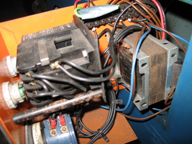

First thing to look at was the electrics. It looks like the transformer has been replaced and some of the wiring wasn't up to standards.

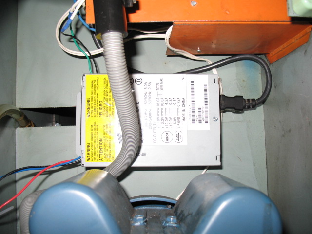

An electric coolant pump (automotive water heater pump) was fitted by the previous owner who powered it with a battery. I still have the original belt driven pump. The electric pump is too noisy but it will do the job. I fitted a modified computer power supply (free and powerful) to provide 12Volts.

Shows the switch gear, relay and transformer before modification.
Shows the modified computer power supply fitted inside the cabinet above the motor.  A toggle switch is mounted on the front of the cabinet so I only runs when needed.
