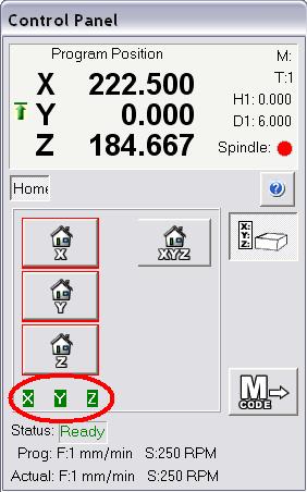

X and Y will home. Z will jog. It seems like the datum switch might be bad. When I move x and y from home, the green marker next to x and y on the vr software disappears. When I jog z from home, the software still indicates that the Z axis is home.
When I try to home the Z axis, It's like the datum switch never registers that the head has come home, because the machine vibrates and grinds something horrible!

If any of the green surround axis letters are showing when you first connect to the machine with the VR Milling ver 5 software, then there is either a problem with the relevant datum switch, datum switch wiring or input on the control board.
X YZ On datum switch.JPG (27.21 KiB) Viewed 23088 times
