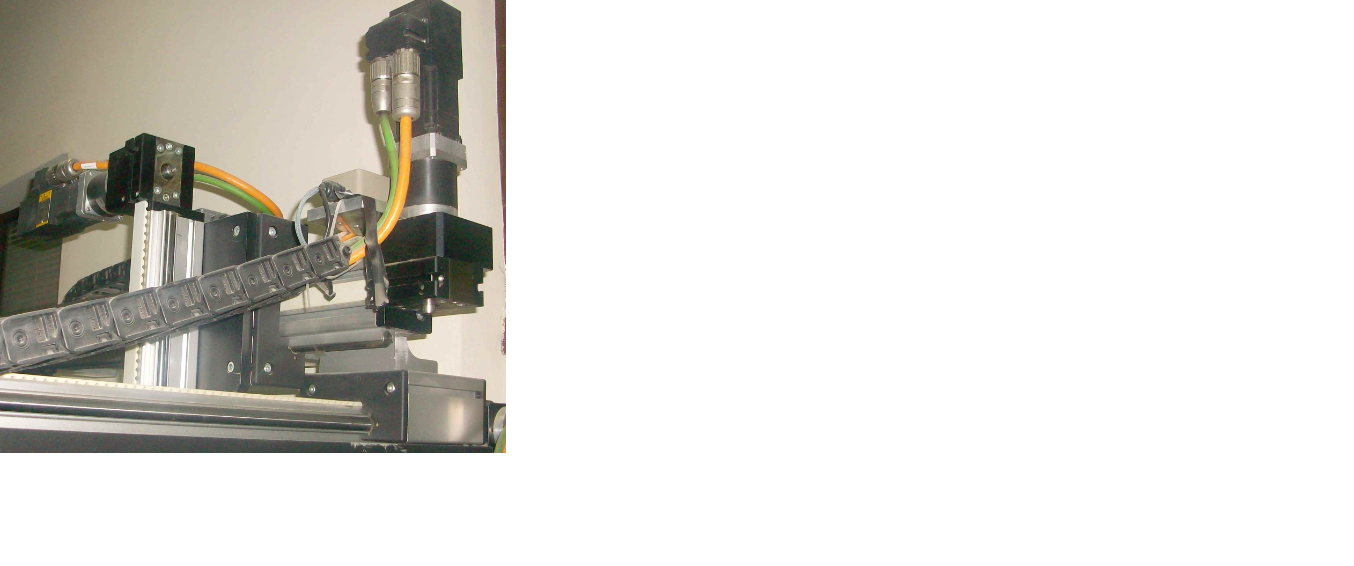

Also look at the axis drive when the drive trips there will be some indication on the drive as to the fault either by a flashing light sequence or alarm display. I am not sure what motors you have fitted but photos here would help.

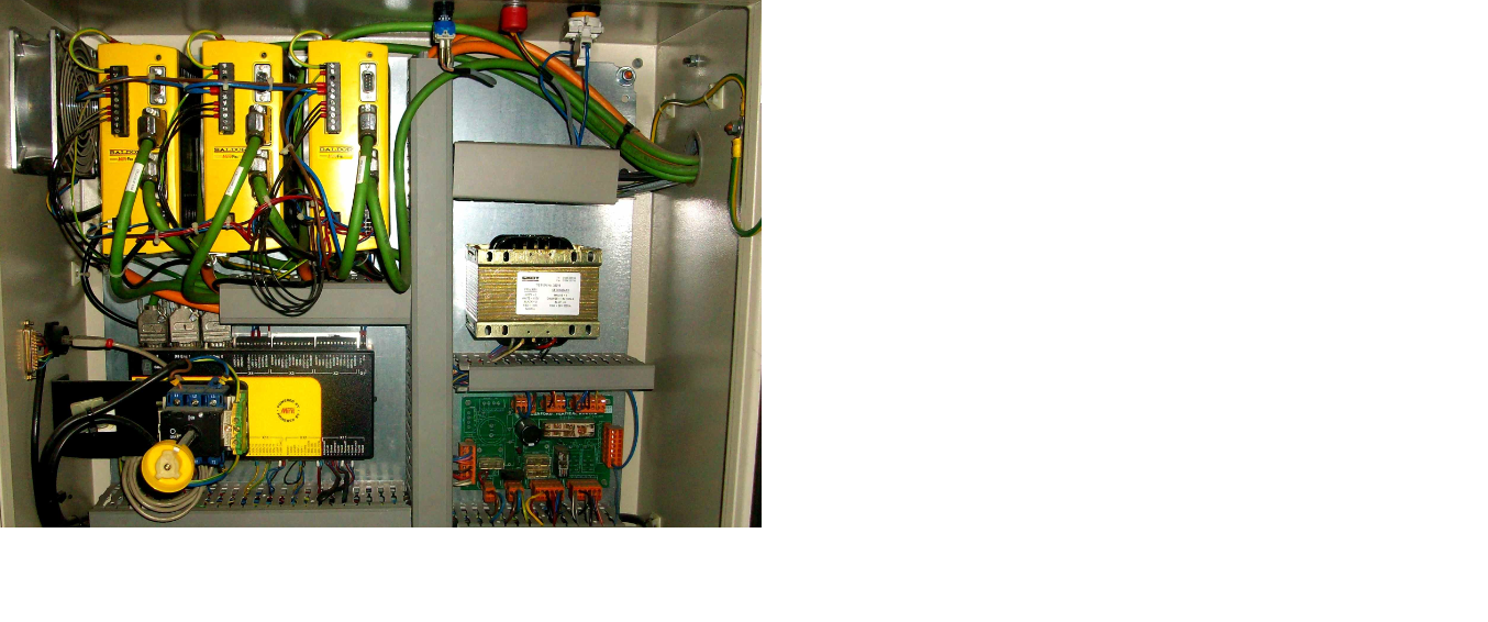

There have been various drive types used on the ASRS so photos of the drive + motor + electrical cabinet will be helpful

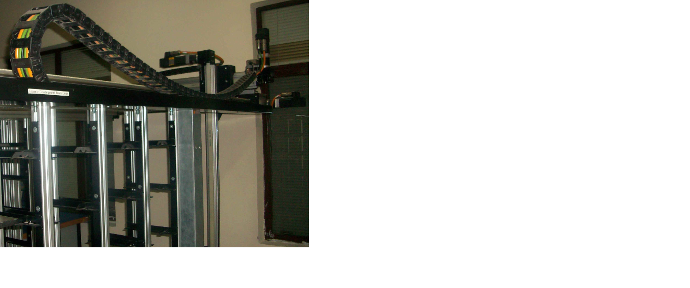

here are some pics of our ASRS control box and the motors..
Re: ASRS drive
we have not touched the electronics yet and need to know where to start.. no idea about the isolater switch either ...

I would get the energy chain that supports the Y axis motor and signal etc cabled repaired or you may get some broken wiring

Turning on the isolator with the door open would be a good start, that's if your health and safety regulations allow you to do so.
Re: ASRS drive
When you power up what do the LED's on the 3 drives do? (What color & if they flash how many times?)

You should be able to turn the isolator circled to the on position with the door open so you can check for errors on the drives.
