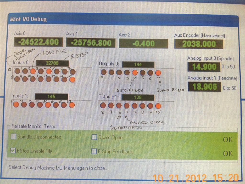

Re: INPUT AND OUTPUT ALLOCATON ON A VMC1300
Attached is a picture of the I/O debug screen which helps identify the Input and Output layout.
Hovering over the indicators identifies them as well
Select the Setup menu from VR Milling 5 and then launce the Debug Machine I/O option when the machine is connected.
