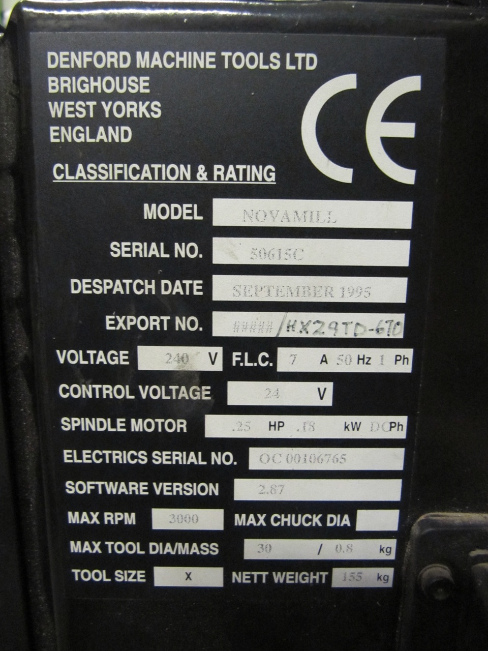

Machine is a 1995 Novamill - serial 50615C. Acquired from Dave at Global Surplus in Halifax.

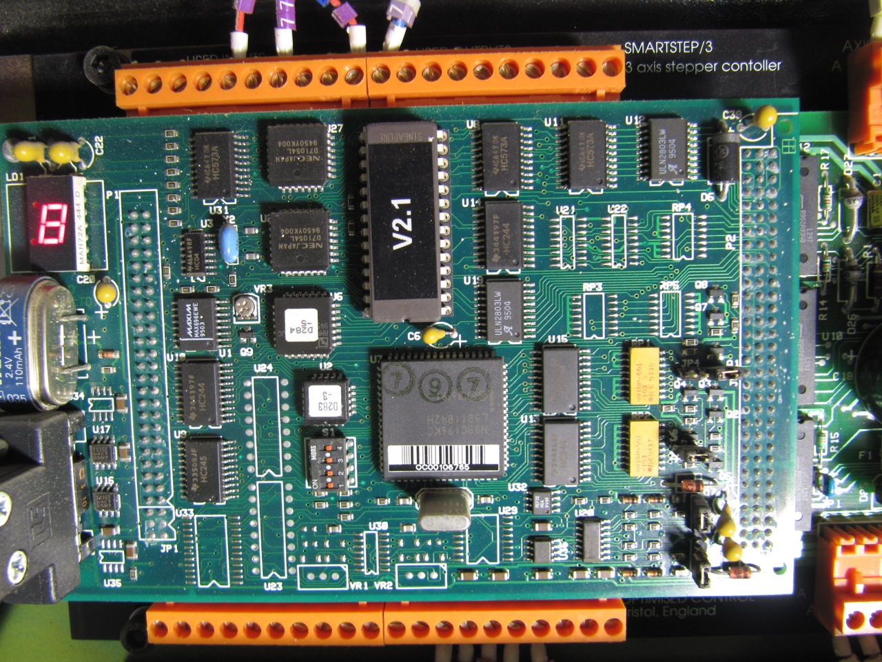

Is this the board I need to remove?

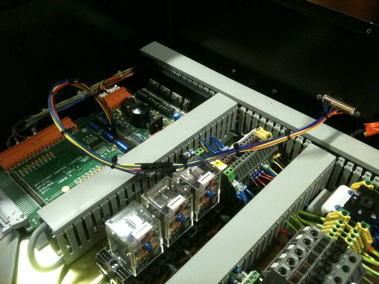

Control box overview
Control box detail
Control box detail

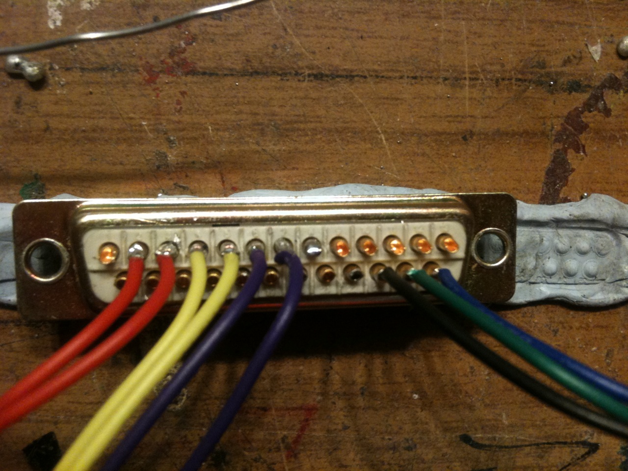

I removed the top board and de-soldered the original wires from the 25-pin chassis connector on the control box case.

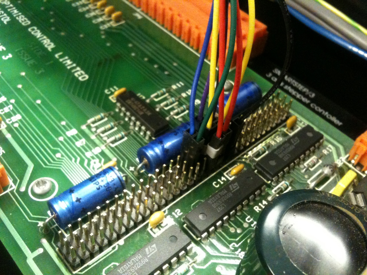

Connected the X,Y,Z axis step, DIRs and GNDs as stated here viewtopic.php?f=4&t=2264
I used some nice jumper/connector cables to connect directly to the massive header - easier than sourcing a 96-pin connector!
Connected to LinuxCNC stepper test program - and, it lives!

Ready to route!
Ready to route!
Connecting wires to 96-pin pins
Soldered + ready to wire up
soldering to the 25-pin connector
