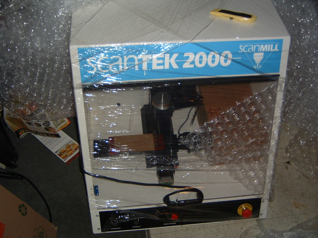

I have a micromill 2000NS. I'm trying to hook it up thru the USB port. The machine turns on, but the software can't find it. I looked at the curcuitboard to see if any fusses were blown and noticed there is a tiny red light on either side of where the fuses are wired in. One is lit, the other isn't is this a sign of what might be wrong? The green LED says 2. Should I just get an adapter and hook it directly to the printer port? My printer port is called LPT3. How would I enter tthat in Vr mill?

so, i uninstalled, then reinstalled vrmill 2. it dosen't say that machine can't be found or isn't turned on. it now says emergency stop is on. also, if i try to press any axis in the window, it says driver not installed. is this getting better?
Re: red lights on curcuitboard
Now this is when you need to release the emergency stop push button & turn the power button which you said earlier did not work. It may be worth dropping the front control panel off & checking for loose wires.
it works!!!!! thanks.
