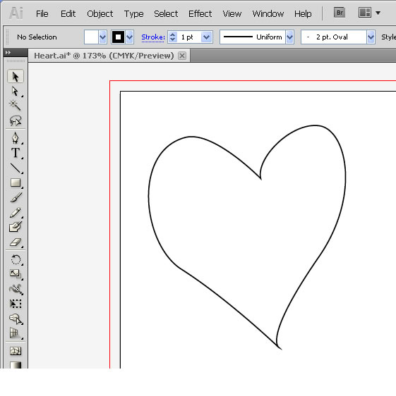

However, I tried it in Illustrator CS5 and the curve was exported as a dxf and it seemed to import OK - maybe you have a version with a .dxf export bug ?
You can try the .dxf I created...

Re: transfer linework from Illustrator to Mill Cam Designer
thanks...will try expand (simplify seems to just reduce the number of points and replace with more arcs)
