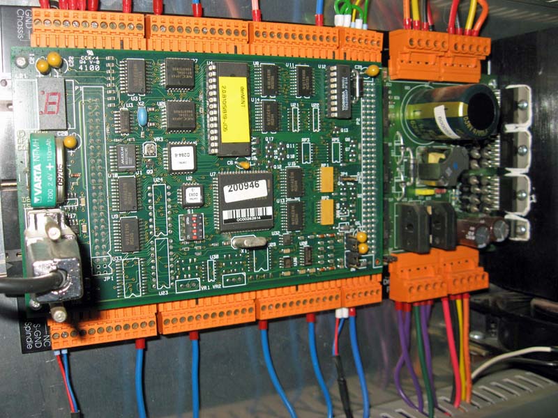

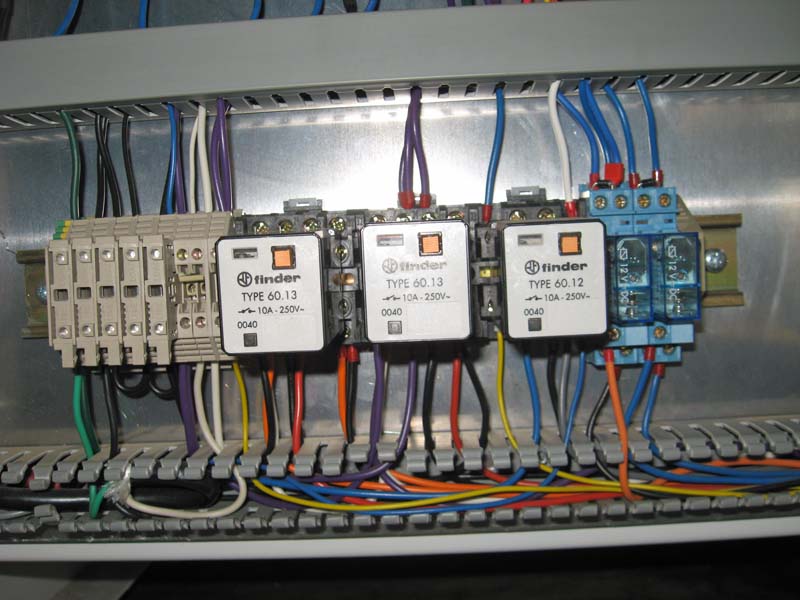

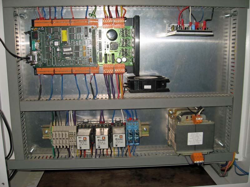

Here are photos of the data plate, electronics panel, and close-ups of the 5 relays and controller.
Speed controller appears to be a KB Electronics.
MicroMill 2000 Controller

MicroMill Relays, Terminals, and Fuses
Electronics Panel
Electronics Panel

Please take a look at the photos of the electronics panel in my MicroMill 2000.
Note that there are 5 relays, not 3 as in the drawings you recommended and that the spindle speed is controlled from the DenStep and not from the front panel mounted pot.

Sorry but I can't find any drawings which match your machine...it could be a development or test machine which would have been documented in the USA office (now closed)
I've added all I could find to this post:
viewtopic.php?f=36&t=2929

Thank you very much for posting the drawings.
The drawing series M2K-AU xx in file Micromill-2000-denstep-110v-1.pdf appears at first glance to be correct for my machine.
