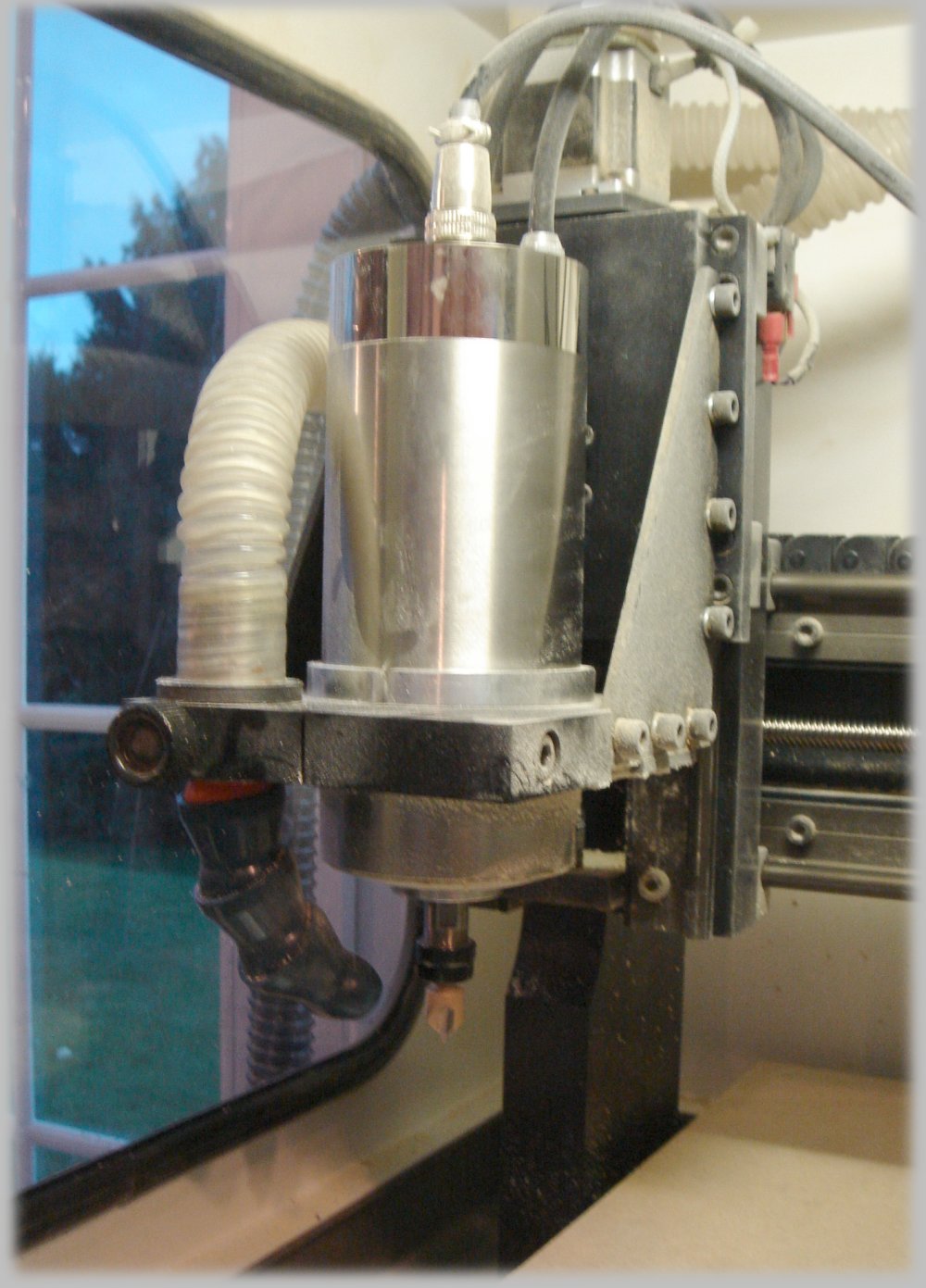

PS I upgraded the spindle in the Compact 1000 to a 1.5hp water cooled spindle (China Version) with ER11 collet and linked the Inverter into the 0-10v conltrol voltage
It works great and I can now hear again! the most noise comes from the water cooling fans. I can still use the original motor if required.

Have you a link to the China spindle by the way ? I guess it's far far quieter than the Porter Cable ?

I got this one from eBay with inverter - https://www.ebay.co.uk/itm/250952849906? ... 1439.l2649
I had a pump and cooler unit so I got this one to avoid more noise and to allow the vacuum collection to work better.
I could have used their Air cooled version. Very accurate ER11 (came with 4 collets) upto 7mm
A simple adaptor ring allowed it to fit into the same mounting hole as the Porter Cable.
Inverter fits into the control cabinet (Above the mains cable input) and is powered on at the same time as machine.
Simple control connections from board 0-10V to inverter. I even managed to connect an overide Motor speed pot.
BUT the power to Spindle On/Off from board was tricky, although there is 24v to power the onboard motor relay there is not enough to power 2 so I just used the 240V out, to the old motor into a 24V PSU (loads around) which powered a relay switch connected to the inverter for Forward on/off to the spindle. It is very simple and quick to change it back to the original motor.
All works fine, much more accurate and it can cut soft metal.
Yes it is so quiet that a mark is needed on the spindle head to show it is rotating.
I attach a pic of the mounted spindle
