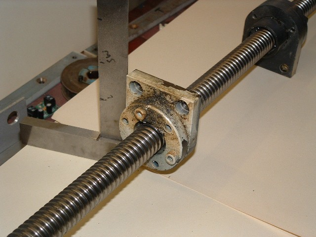

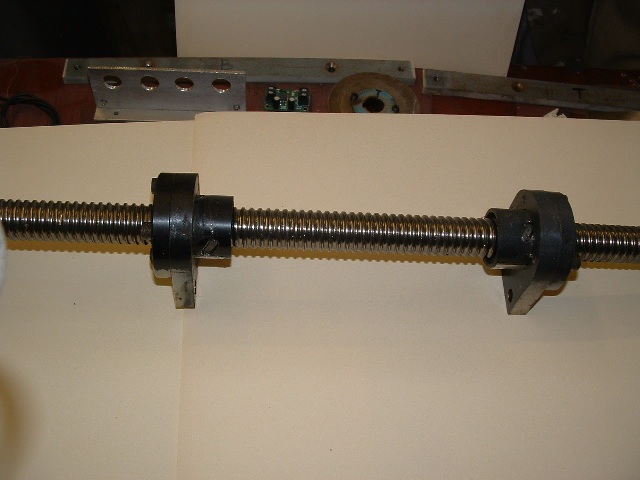

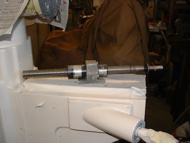

Here are 3 photographs of the Y axis ball screw and nuts. The nuts are by Warner Electric, the front (pulley) end being RM 2505 UF, the rear one is RM 2505 A. They are non-adjustable, have no pre-load and (sadly) no wipers.

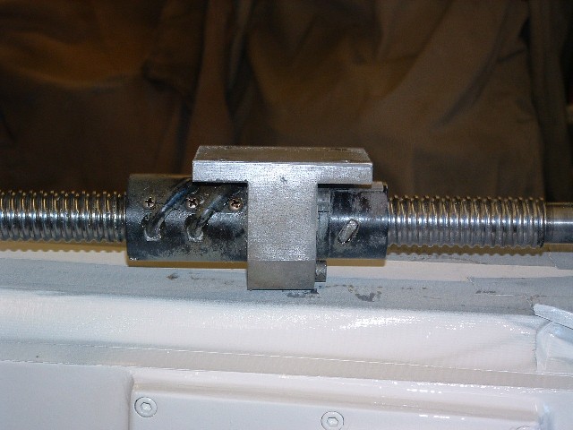

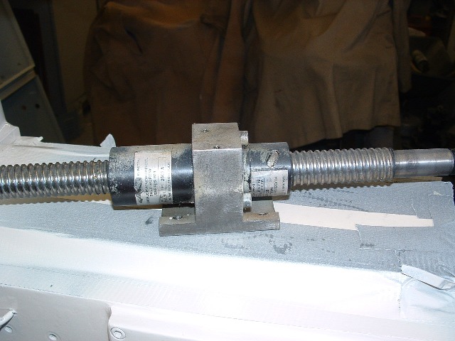

X axis nuts are Warner Electric series RM type 2025 UF, attached in their carriers to the saddle by 2 capscrews each end.
