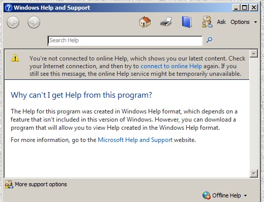

Help not displayed on windows7
Cannot seem to get to the machine help to display. The help tries to connect to the internet?????

This is from the ff1 or the help menu on Win 7 and on 2 new XP installs
See screen shot.
Help window.jpg (70.97 KiB) Viewed 29817 times

I think I have the answer.
The machines with the problem are all windows 7.
It seems this version does not have the software installed to view older help files.
The following link should resolve this.
https://support.microsoft.com/kb/917607
Will confirm when tested.
Re: VR Turning v1.28 released 30th Nov 2011
Downloading and running this exe has resolved the problem.
https://www.microsoft.com/downloads/deta ... 8e02b32a2c
