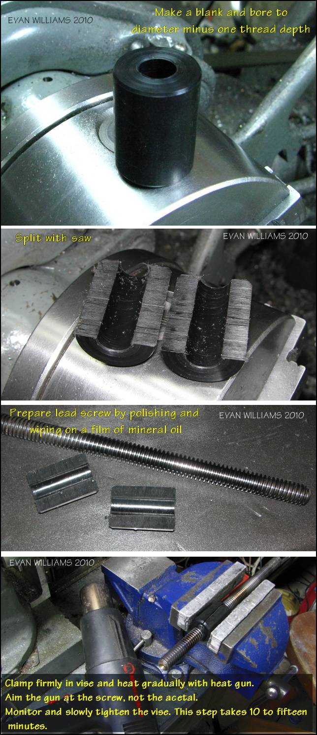

The nut may be removed from the screw by chucking up the nut and and clamping the screw with vise grips, then turning it off in back gear. Use some oil on the screw and take it in small stages to avoid overheating the acetal from friction. After removal the nut may be chased out slightly by grinding a small slot on the end of the screw a couple of threads long. Put the nut in the fridge to shrink it a thou or two and then chase it with the screw while cold.
The nut and screw should be left to cool until both can be comfortably touched for a few seconds by bare hand. Then it may be water quenched the rest of the way to cold before attempting to remove the nut.

Chasing the nut if it's a bit too tight...
I ground the screw to use it for chasing the threads like this:
This worked perfectly if you want it still slightly tight. Freezing or cooling it first should produce a perfect smooth fit. If you are using a screw that is from the machine then grinding just a small notch at one end should be sufficient although it will take more passes.

In the picture where the leadscrew is chucked to the lathe, how do the two halves of the plastic hold together? Is it the heating that bonds the two?
The melted acetal squeezes out into the kerf and heat welds the pieces together. I wouldn't depend on it in use so it would be a good idea to make a sleeve either from acetal or metal and press the nut into that.

What is the melting temp of acetal? Are we just going right up to the melting threshold with the heat?
Short answers: 338F (170 Celsius), Yes.
Long answer: Acetal is limited to a maximum working temperature by the heat deflection temperature. This is load dependent. At a couple of hundred psi ( easily applied by the vise) the deflection temp is about 250F. This is when it begins to thermoform and consequently the amount of heat transmitted from the screw to the acetal increases as the contact area increases. As the temperature continues to rise the material softens further until liquidus is reached. This is easily observed as the acetal will quite suddenly start to flow. At that point the vise can be tightened some more and the acetal will squeeze out into the kerf and out the ends. It is important to heat mainly the screw as we don't want to melt the entire mass, only the inner portion.
