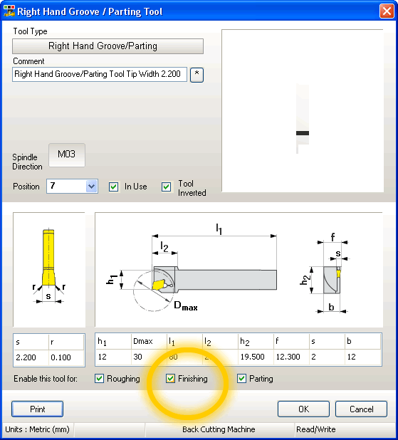

From what I understand you should turn off finishing for the grooving tool...
Under menu Options>Machine Tooling - click RH Groove/Parting tool and Edit.
Re: Quick Turn selecting wrong tool
Yeah i did this and it does finish with the left hand tool however it still roughs with the parting tool, which includes roughing around an arc which means sideways movement which pings the tip out. Surely it should do all the left hand processes roughing and finishing with the cutting tool?

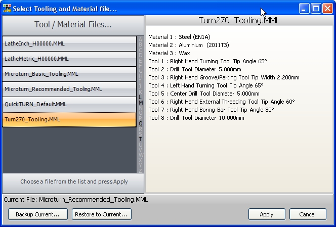

By default in both VR Turning and Quick Turn tool 1 is the RH tool, tool 3 is the LH tool, tool 5 is threading and tool 7 is parting. This is how they would be fitted if you had a turret.
The tool definitions in the program are not correct as both the right hand and left hand tool have a 65 deree angle. In your program the LH tool says its 34 degree.
Can you check what version of Quick Turn you have? Version 1.12 was released in march 2012. If you have an older version download the current version and install it.
https://www.denfordata.com/downloads/Qui ... _v1.12.zip
Then you need to load the correct tool library from the options Menu (as shown in the quick Start guide) This will tell you at the bottom what tooling is currently loaded but you can select the TURN 270PRO default tooling option as shown in the attached screen shot.

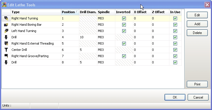

I would edit the VR Turning tool library and make it match the Quick Turn 2D settings.
The second attachment shows the tools and turret positions
Tool turret positions.jpg (120.09 KiB) Viewed 28870 times
Tooling Library in Quick Turn.jpg (164.51 KiB) Viewed 28870 times
