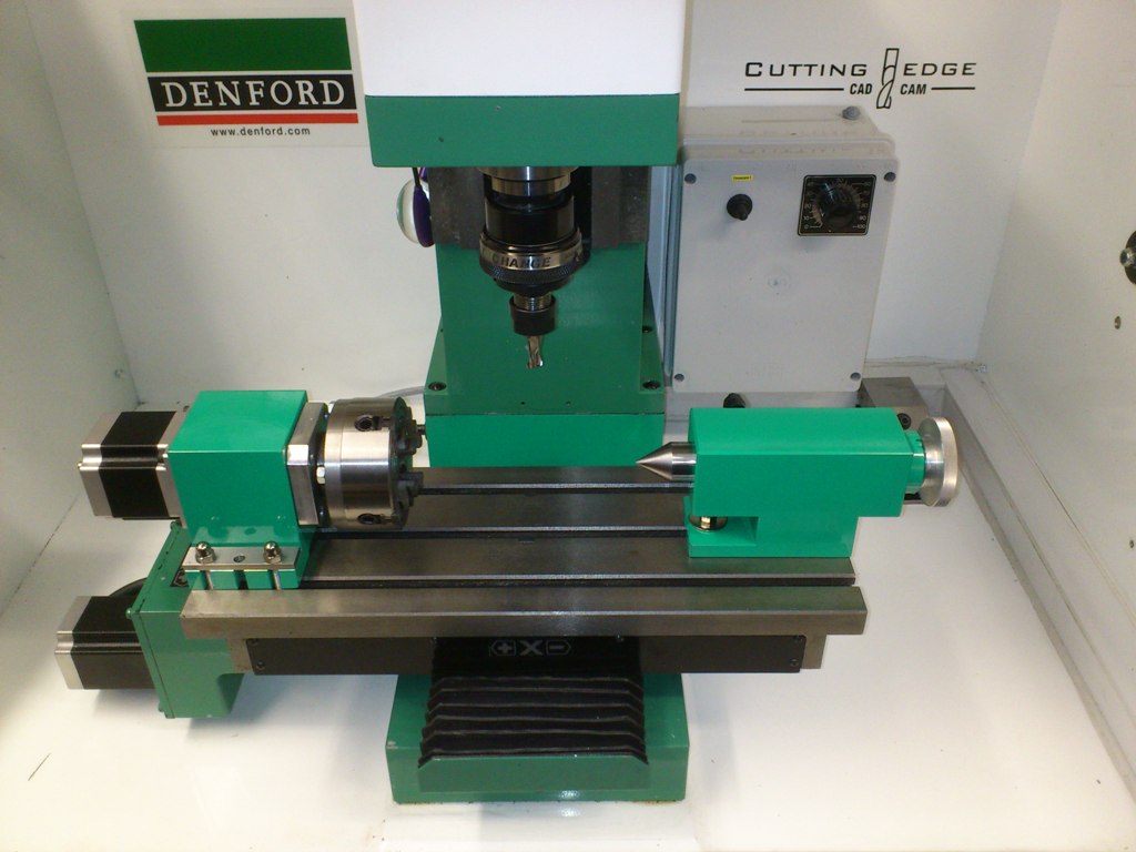

It was always part of my plan to have a 4th axis but with all the retro fit and mods it got put on a back burner. But finally I have got around to it :D
I had a look around at all the usual rotary tables and couldn’t really get away from the backlash issue in the worm gear arrangement. I thought about putting together my own but decided the best way to go was with a harmonic drive. Having used these in work I knew they had minimal backlash and massive reductions although maybe not so good under large loads. The downside of these is the price, the ones from Germany where hundreds and even thousands depending on the spec.
Then I spotted this on ebay! A 4th axis advertised for a cnc router and it uses a harmonic drive all for just over a couple of hundred quid :mrgreen:
It arrived after a couple of weeks and was pretty rough to look at just in unfinished aluminium with a shocking Taiwan 3 jaw chuck. I cleaned it up, changed the way the bearings were preloaded and skimmed some of the surfaces and with a lick a paint it looks the part. I also bought a 4 jaw from Chronos. Having adjusted the preload and just giving it a general tidy up it runs a lot smoother that when it first arrived. I Think in its supplied condition it would have been a bit rough and the load on the motor just from the mechanism would have been huge.
I haven’t cut metal with it yet but its positional accuracy looks good (as good as I can tell with a wixey digi angle gauge)
The tailstock was supplied in a similar state, just unfinished ali, with a few knocks and dinks in. I lobbed off the rear mounting lug and machined a slot in the rear face to house a nut.
All in all I`m quite pleased with it now. I don’t think it would be that great for hard work but for my light cuts on model heli parts I`m sure it will be good. Time will tell...Just need to think of something to make on it now :delirious:

Thats the one! I bought the tailstock from the same guy too.
I priced up the harmonic drive on its own from china and it is about £200 so I dont think the whole unit is that bad a price. (if its the same make of harmonic drive)
I think the design needs a better bearing arrangement as there is no real way of setting the preload but just to tighten it up a little more so you can go from too loose to too tight. There is no spacer between the bearings so its just a case of how much you press the end one in.
The chuck was rubbish too.
Apart from that looks good! :) . I`ll cut some metal on it this weekend. I have been busy with a starturn conversion :D

Morning! Unfortunately I didnt take any photos of the drive when I had it appart but the arrangement was quite simple, maybe a little too simple for what a harmonic drive needs for good running.
I once worked on an actuator concept and we had more alignment features and some additional bearings than whats used in this 4th axis but I guess this was designed with a slightly less budget than aircraft components have :)
I have observed some testing for space applications and it appears the efficiency of the drive does fall to about 40% over time and one thought was that the drive pushes the grease away as the flex spline walks around the outer ring gear. This would be less important if the lubrication could be re-applied (not so easy in space!)

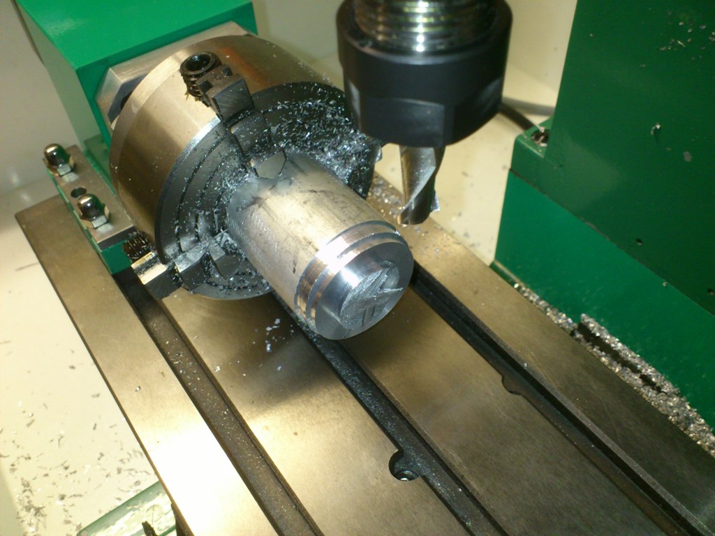

I have had a play and the results were good. I did a simple skim of the face and the suface and got a runout on the face of 0.01 or thereabouts and 0.05 on the outer surface, which is more or less what I measured on the 4th axis chuck backplate.
I then tried a spiral cut using a 6mm ball nose cutter. I cut a depth of 2mm first, then 0.5mm then finished off with 0.2mm I thought the results from that looked pretty good.
I would probably use the tailstock on everything if I could as I did see a little deflection when I tried a heavy cut. With the unit being quite small and the shaft bearings quite close together I wouldnt expect anything less, seen the same with small rotary tables e.t.c
The stepper motor got warm but nothing more than normal and the repeatability seemed good so the harmonic drive seems to be doing a good job without slipping. I would probably limit the depth of cut to 2mm and in my application I would only take very light cuts in steel (not that I use steel much) The feed rate is a bit of a tricky one as the surface speed will depend on the diameter of the workpiece but I think I was cutting about 60mm/min
