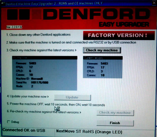

Install and run easyupgrader from the V5 milling CD (screenshot shown here viewtopic.php?f=54&t=1396)
Connecting to the card from easyupgrader will check the firmware of control is up to date...
There was an old issue with the firmware where the axes never got to position to tell VRMilling to send the next block. There were also issues with corrupt USB data not being resent properly and hanging up the program.
Re: Novamill hangs
Hi - tried easy upgrade, everything checks out (see image)
