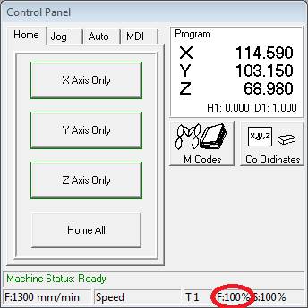

Running Windows XP and VR CNC Milling 2.28 This is the first problem with the machine. Any suggestions on what the problem might be? I have re-installed the software with the same results. I have also installed on another computer with same results.
Manual feed has been set to max with no effect.
Re: Microrouter will home but will not jog
Check that the feed overide button is not on 0%.
It's also worth checking the jog keys definitions haven't been tampered with:
viewtopic.php?f=8&t=729
