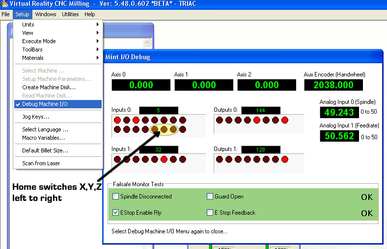

Make sure your version of VRMilling is higher than 5.33
Then, when connected to the machine, select the menu Setup > Debug Machine I/O
From here, you will be able to test that the home switch inputs are working:

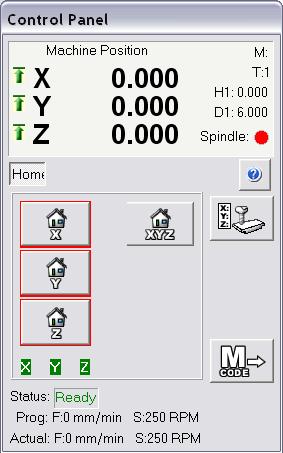

Before homing any of the axes, you could press and hold in, any of the datum switches and if the switch, wiring and input are OK, then you would get an axis letter with a green border being displayed in the control panel window. (see below)
Datum Switch - wiring and Input testing.JPG (26.1 KiB) Viewed 20305 times
