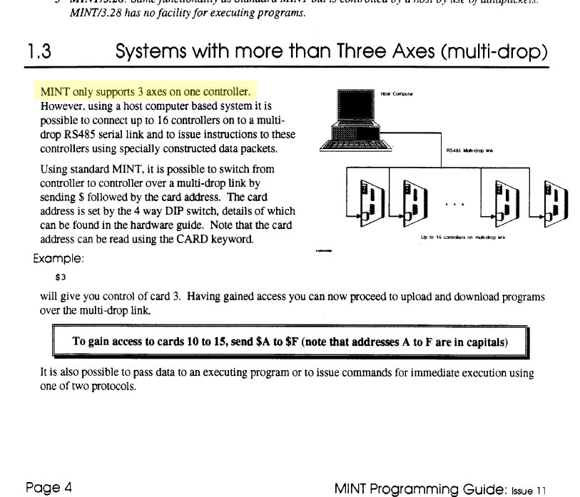

I've just had a look at the Denstep mint manual and it would seem that it was only capable of 3 axes anyway...
email technical :bert: denford :ernie: co :ernie: uk to see if they can supply an older Nextstep (RS232 only) top card (as these are often replaced in USB upgrades)

OK thanks for all your help.
At least I know that my current kit wont cover the job. I'm going to look into using my rs232 stepper drivers to controll a lightweight 4 axis machine but if that doesnt work out I'll drop technical a line and find out costs of a nextstep card.
