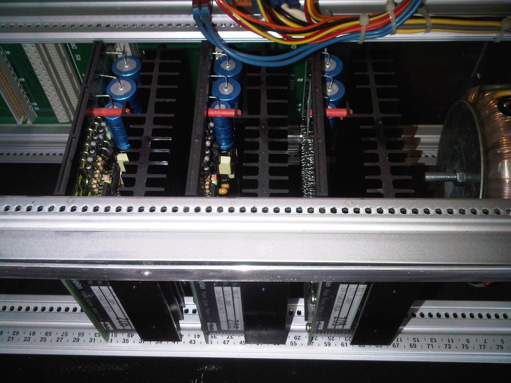

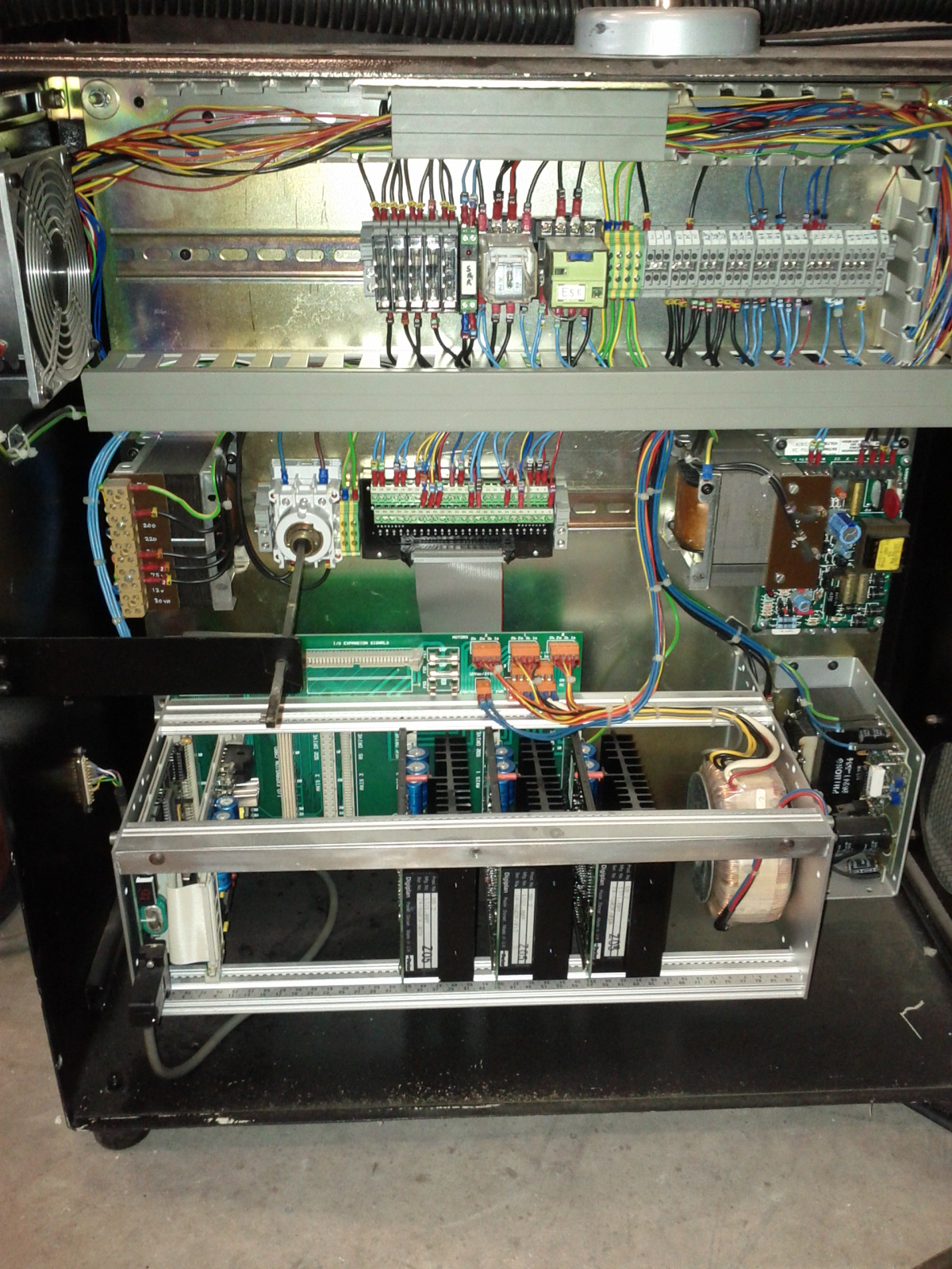

overview
overview
overview
overview
I bought one of the machines from rowboat and I am attempting to convert it to mach 3 also. My electronics knowledge is limited though. I do have some help from a friend however he has never worked on a cnc machine.

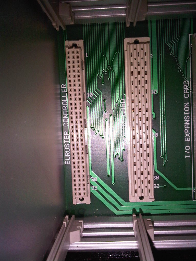

I have posted some pictures. :delirious:
main board connections for controller card and custom card

The CNC4PC board will talk directly to the original stepper drivers without a problem. You need to identify which pins on the drivers are step, direction and ground then trace these through whatever lead connected these to the original computer board.
It might be best to buy a socket, solder it to a piece of strip-board and make a break-out for the end of the original lead (probably a ribbon cable). Then connect them to the CNC4PC board via bits of connecting wire.
You need to identify what each of the relays does. There will be one for coolant, two for spindle (either one for forwards + one for reverse or one for On/off and the other for CW/CCW - the circuit diagram should shed light on which) maybe one for machine lube, possibly cooling fans and certainly one for machine power (power to the motors & drivers, independent of the supply to the computer.
The CNC4PC board has a selection of relays. These should be used either to switch the mains in the case of low current things like the coolant pump or to switch the 12 / 24v to the original relay coils for things like machine power.
The biggest challenge with these is the interface to the home / limit switches. Some Denford machines use difficult to interface 8v sensors. If this is the case, I would strongly recommend you swap these for modern TTL proximity switches (available from RS) which will talk directly to the CNC4PC board without any additional electronics. I wish I'd done this on mine!
The spindle speed is controlled by a 0 to 10v supply which the CNC4PC board will generate. It has a 12v supply input specifically for this. It is VERY IMPORTANT that this is fully isolated from any other supply. If not, it will damage the CNC4PC board and if you are unlucky the spindle inverter too. Either use a 12v to 12v Isolating DC/DC converter or an isolated 12v Power supply module - both of which are available from RS. It barely draws any current - so something around 5w will be plenty. Do not use this supply for anything else.
A project like this requires a certain amount of reverse engineering which only you can do. There is no pre-defined route-map for how to do a conversion. How about just asking specific questions when you get stuck?
