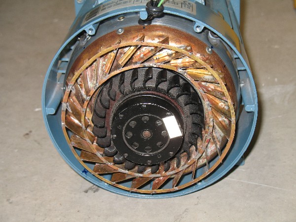

First I converted the motor. This required replacing the shaft driven cooling fan with a motor driven fan. The heat produced by a motor with VSD is the same regardless of speed. A shaft driven fan is too slow at slow speeds and soaks up a lot of power at high speeds.
I used a recycled centrifugal computer fan. This required covers to direct the air and a diffuser to prevent overloading the fan motor.

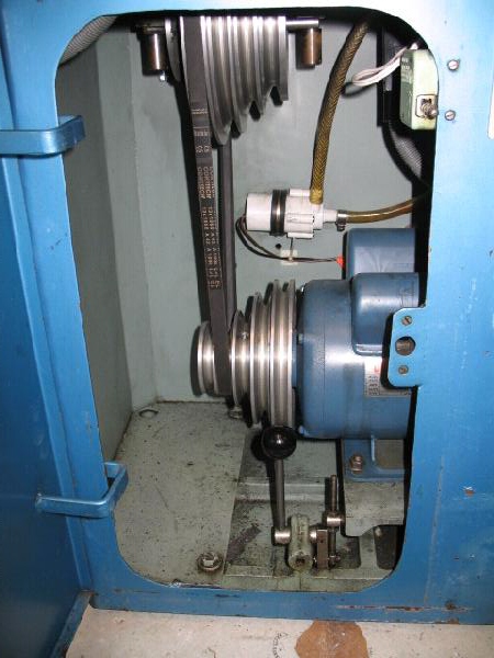

The standard motor and pulley set.  Note that the standard belt driven Denford coolant pump has been replaced with a windscreen washer pump.

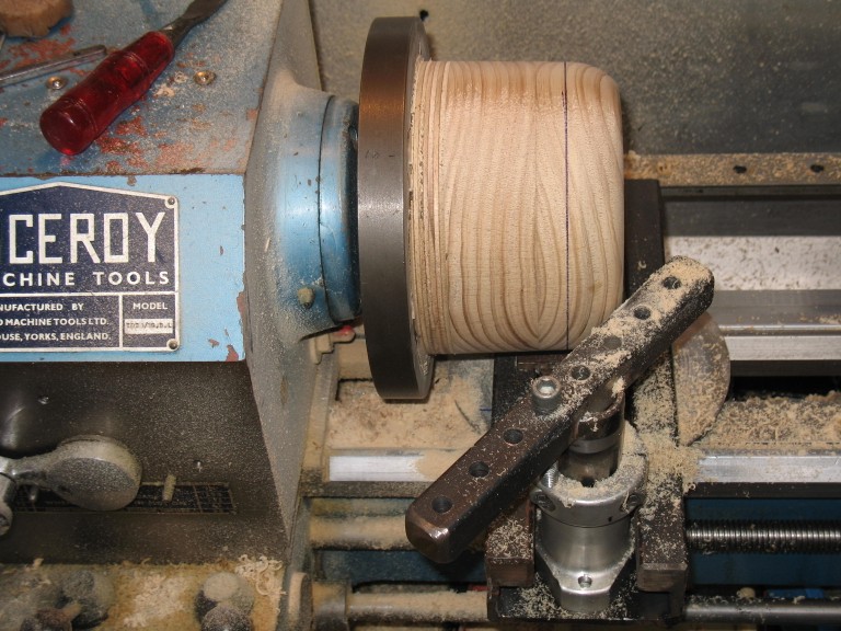

I made a wooden form in order to metal spin the covers.
IMG_0281 (768 x 576).jpg (135.77 KiB) Viewed 67971 times
I spun the covers on the Denford
IMG_0284 (768 x 576).jpg (121.1 KiB) Viewed 67971 times
Underneath the spun cover is a recycled computer fan with a copper sheet diffuser.
IMG_0728. smlJPG.jpg (88.84 KiB) Viewed 67971 times
The finished motor ready for a VSD.  All of the modifications are reversible.  The standard fan can be restored.  The air intake venturi is made from a piece of 220kV cable.  The copper core was removed and the insulation turned to provide a smooth air intake.

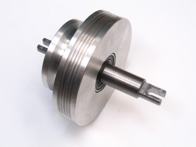

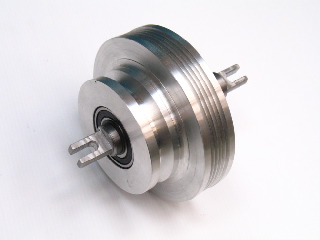

The next major part was to make the new pulleys. I an replacing the Vee pulley with a poly-vee pulley that fits on my car. Automotive belts are substantially cheaper than industrial belts.
I made both the pulley and a new jack shaft.
Dazz
The finished jack pulley.  A Vee and poly-Vee
IMG_1840 (648 x 486).jpg (37.51 KiB) Viewed 67970 times
IMG_1842 (648 x 486).jpg (37.96 KiB) Viewed 67970 times

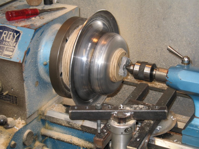

Re: Denford Viceroy TDS VSD conversion
Metal spinning is not as easy as it looks on YouTube.
Aluminium for spinning must be one of the soft grades (100% Al is good). A random piece out of the scrap bin is unlikely to work.
Aim for a bell-shape during the spinning. The edge needs a curve to stop wrinkling. The photo above shows the edge curved back to the right. This is bad and difficult to recover from.
The spinning tool must be applied from right to left to draw the metal down over the form. Equally the tool needs to be applied from left to right to prevent the metal from thinning out to nothing.
Practice a lot.
Dazz
Dazz

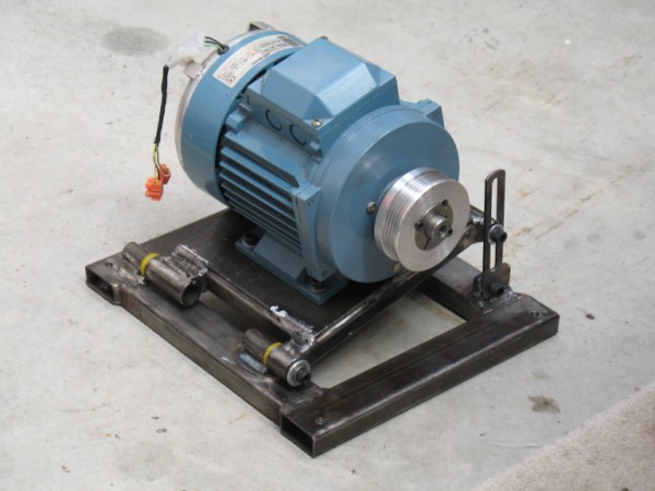

The next stage is the replacement motor mounting arrangement. The factory mount is too floppy to use with poly-Vee belts. They need the pulleys to be accurately aligned. The new mount is a bolt in replacement for the factory items.
The mount was fabricated from rectangular steel tube. It is much stronger than it needs to be but I just made use of materials on hand.
The hinged motor mount is designed to allow the motor to be extracted while still bolted down to the mounting plate.
The yellow items are nylon bushings intended to provide a firm fitting hinge that won't rattle. The hinge pins are supported at one end so that the motor mount plate can be slid off. A bolt on the end of one hinge pin stops the motor mount plate sliding off by its self.
Two height adjusters are included for extra rigidity but only one is needed.
I need to paint it while I prepare the VSD and related items for installation. I plan to fit a digital tachometer and load meter.

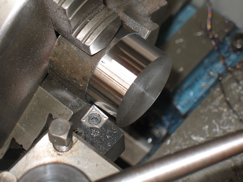

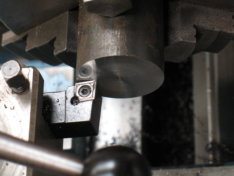

The photos show a sample of the finish achieved on my next project.
This is a manky old piece of hot rolled mild steel.
With HSS, the finish is like sandpaper on this metal.
With cermet tooling and smooth VSD, the finish is what you see.
Note the reflections of the tool on the workpiece. Not too far from a mirror finish.
Dazz
A sample of the finish achieved.

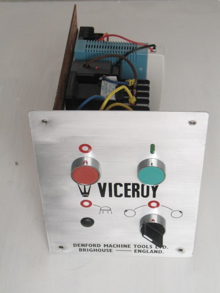

The refurbished control panel was recycled for the conversion.
IMG_4698 (450 x 600).jpg (35.88 KiB) Viewed 64628 times

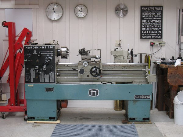

Hello
I am converting my other lathe to VSD and have fitted a 3 phase/4kW/ 220VAC motor.
It's only taken a year so far.
There is no Nardini forum on the web so I won't be posting progress on this anywhere.

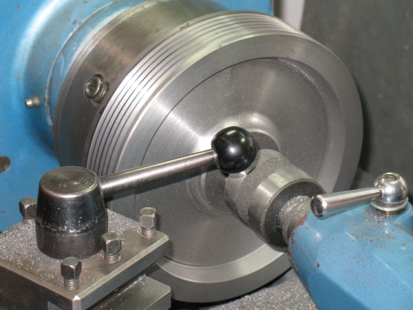

I made a poly-vee pulley on the Viceroy
A Brazilian made lathe designed by Engineers who fled from Germany after the war.
IMG_3856 (600 x 450).jpg (63.87 KiB) Viewed 64628 times
The pulley had a tapered and keyed bore.  I had no choice but to make it.
IMG_4397 (600 x 450).jpg (59.31 KiB) Viewed 64628 times
The poly-vee pulley ready to fit to the lathe.
IMG_4590 (600 x 450).jpg (34.79 KiB) Viewed 64628 times

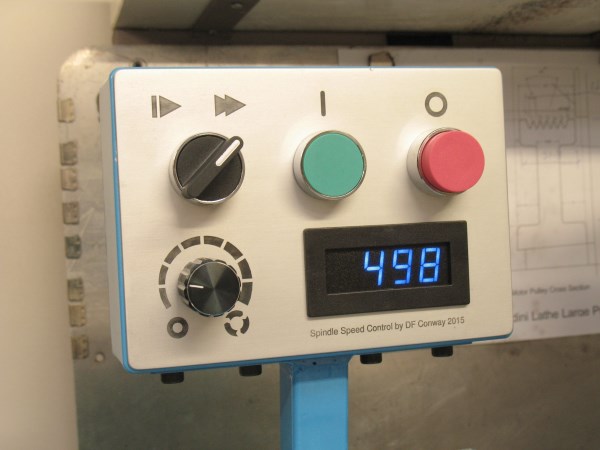

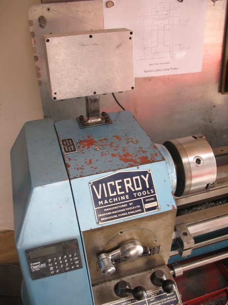

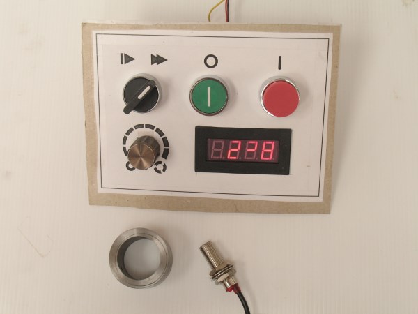

Here is a close up of the upper control panel.
I made a cardboard mock-up to test appearance and ergonomics.
The panel was mounted on a stand over the hole for lamp.
All of the cabling goes down through the inside of the headstock.
All of the VSD controls a fully remoted so there is no need to access the VSD.
That is mounted above the motor inside the cabinet.
Apart from the upper control panel, there is no external indication that a VSD is fitted.
I have tried to make it look like it could have been factory fitted.
