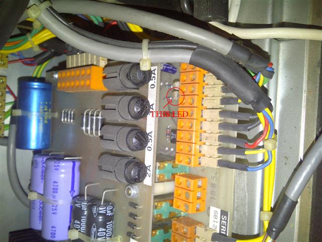

If I leave it powered on for a 15 seconds or so, one of the red LED's on the board to the left at the rear of the machine flashes erratically, and is accompanied by a relay clicking. I have attahed a picture to show which LED it is.

I believe the smell to have been the back of the screen as there is visible scorching to it (and now it doesnt work).
I can start the spindle in manual, but not increase the speed. If I leave it for a few seconds, it suddenly ramps the speed up itself really fast, the slows down or stops, very errattic.

Where does the spindle command analogue come from on that machine ?
From what I've seen of an old starturn8 there is a seperate control board which I'm guessing takes a digital command signal from the CNC control and converts it to analogue command to the spindle drive. You may be able to fit a potentiometer to the spindle board and control the speed from there - at least then you know which bit is being erratic if it fixes the problem...
My guess is that the main control board is faulty as the drives aren't working either - check the voltages on test points (if there are any) and do the usual close inspection of relay contacts, solder joints, screw terminals, pin sockets etc etc

Ok, I appear to have found the problem - I hope :)
I was fairly sure that the burning smell was coming from the CRT screen, so I pulled the connector plug on the circuit board which feeds the screen off, so that there was no power to it.
When I powered the machine back up, all axes now move, and the spindle is functioning correctly again.
I guess that either the screen/tube itself or the driver board had developed a fault, and was sending corrupt signals back to the main board????
Anyway, the machine now appears to be ok, other than I have no screen to see what is happening, so will try and source a new one.

Re: Strange Orac problem
I think the blown screen was pulling the voltage down so that everything else was only half working.

I think it is the board which supplies the screen which is at fault, as I removed the screen from it, then plugged the power back on to it and the problem was still there.
