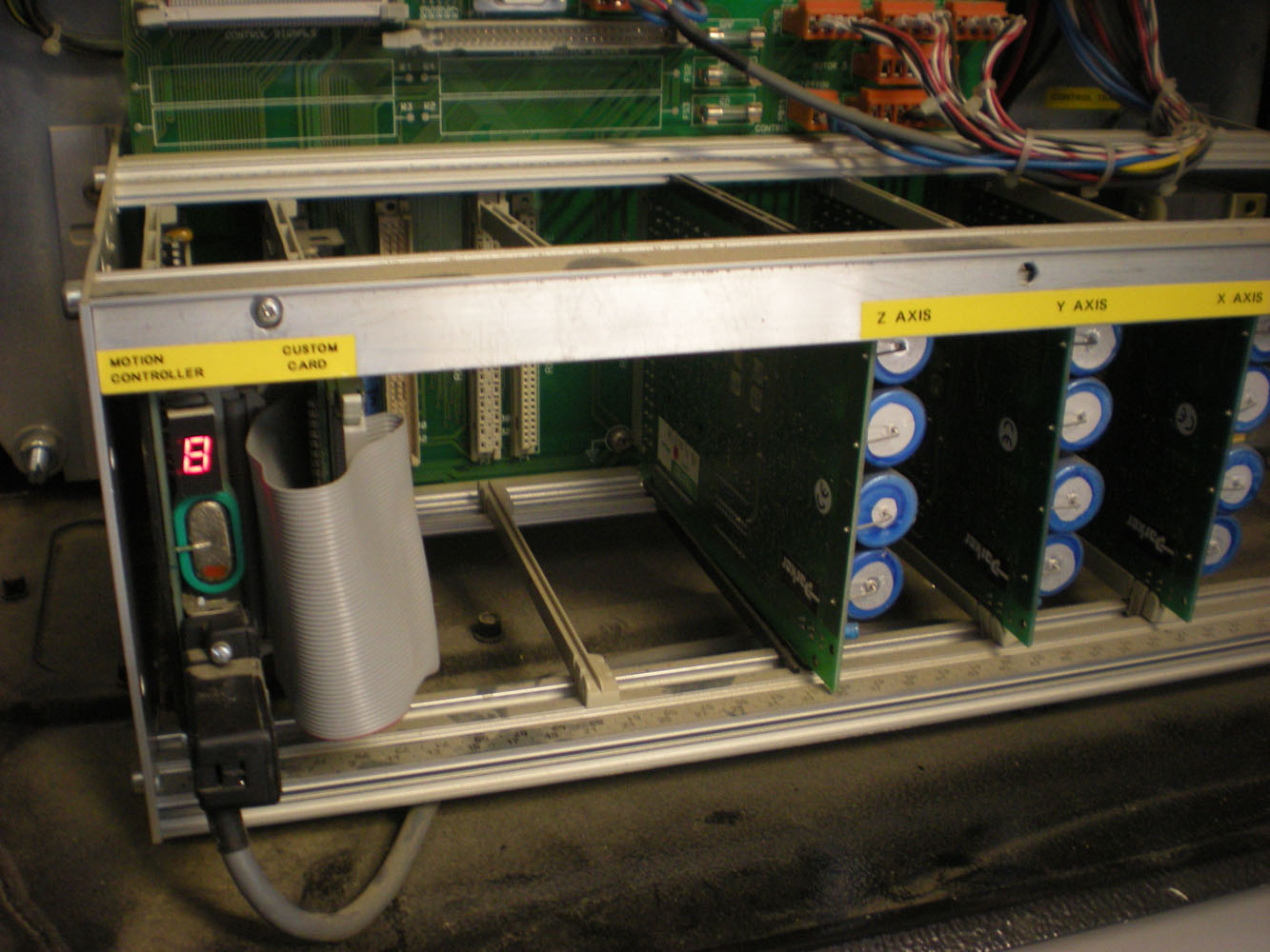

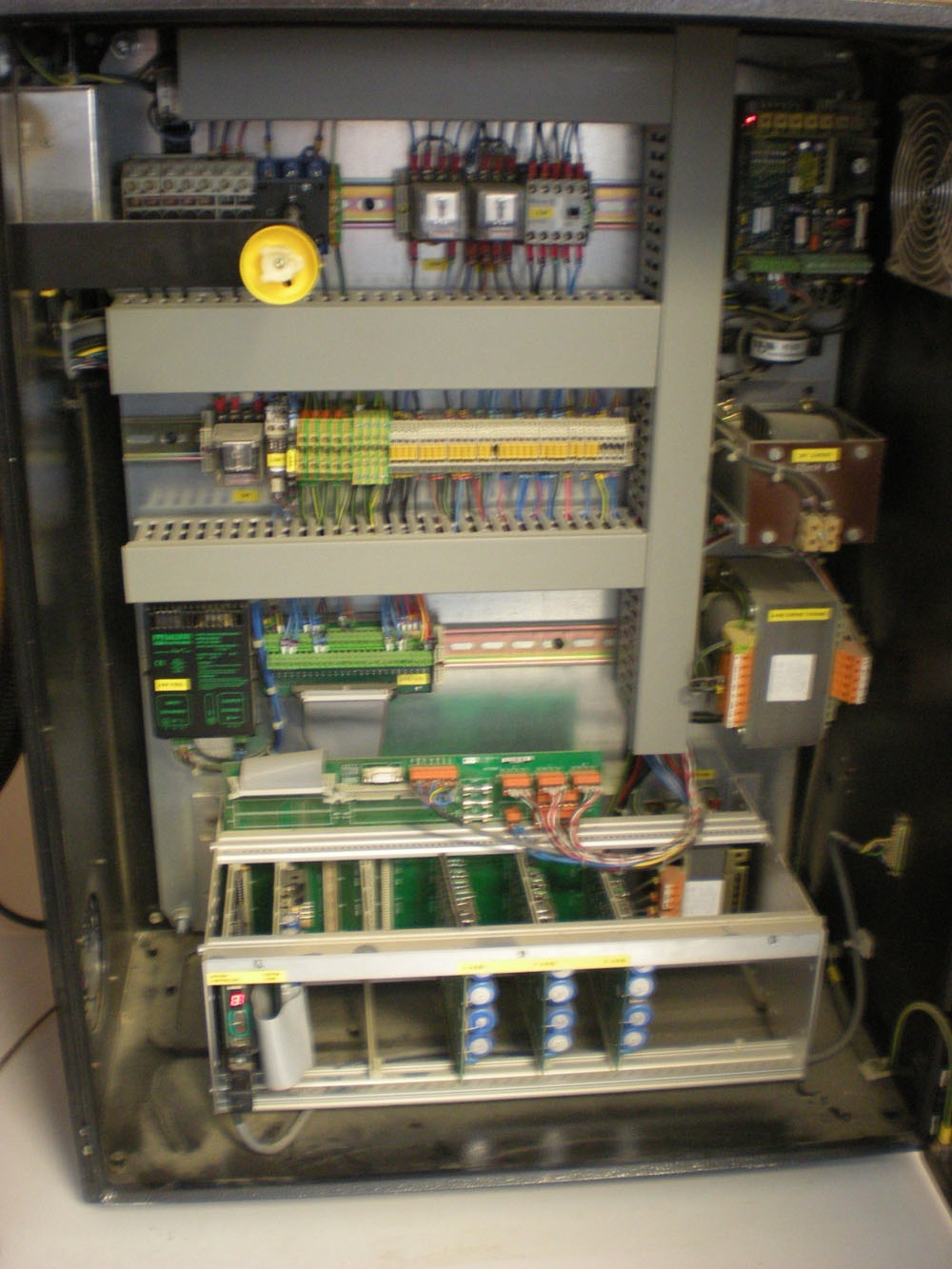

It is a rack system. I have checked the seating of all the cards and these seem fine. I have also attached a photo of what I am seeing when the machine is powered and connected to VR milling. On start up the card shows a L then the decimal point LED flashes and it then displays 8
This photo is taken with the machine powered and connected to VR Milling

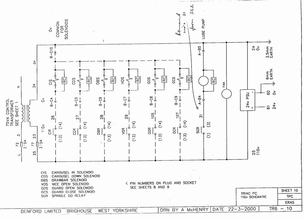

Thanks for your help so far. I have had a look at what could be causing the shorting out of the SGR SRR and through a bit of trial an error I have narrowed it down to wire 31 that comes out of the SGR. Without this connected the machine will connect with VR Milling and on M3 (Spindle Forward) wires 60 and 61 do not drop to 0V. The SGR switches but nothing happens due to this wire being connected. VR Milling stays stable and responsive. What I haven't been able to determine from the wiring diagrams is what wire 31 connects to. I have attached a copy of the wiring diagram that indicates it may be the lube pump but have not been able to locate any other instances of wire 31 in the cabinet. Any ideas on how to go forward from here? Thanks again.
Re: Homing Problem on Triac
Wire 31 would normally be part of the 100volt line which as you say would power the lube pump. It would also power any solenoids fitted, the fan in the cabinet & also the 24volt DC which is what is dropping off.
It may be worth testing the continuity of wire 31 from the SGR to the lube pump on the back of the machine.
