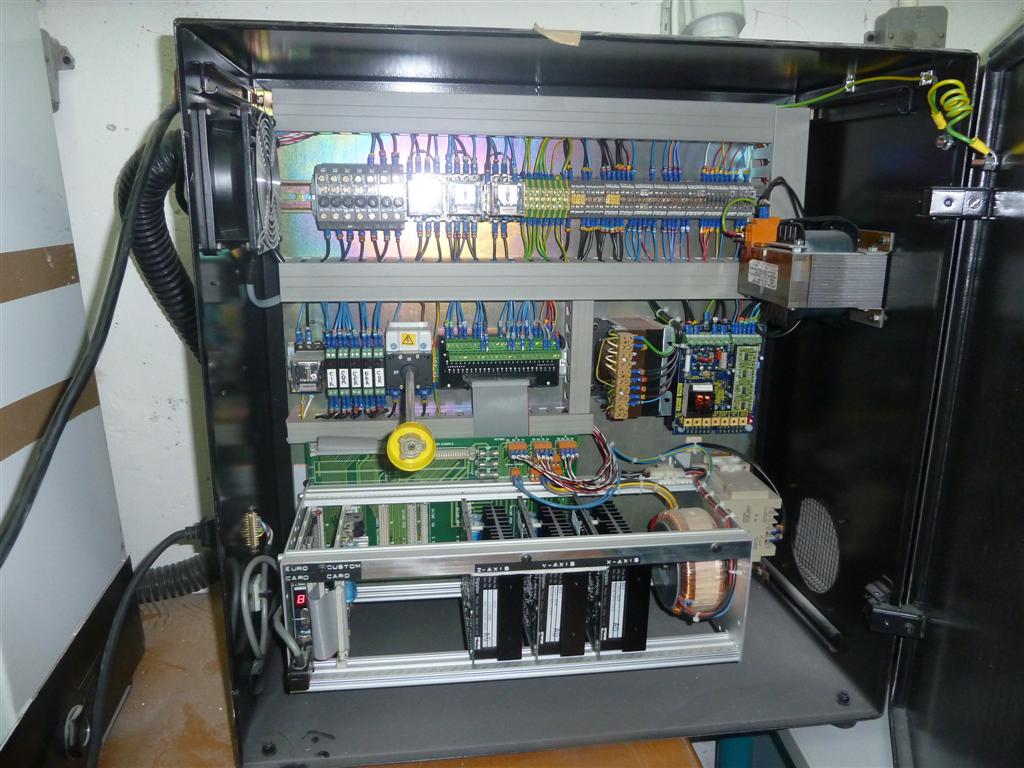

After all i suspect tha the problem is IN the Machine ( as i have read in the forum ) . The sgment display always light the number 8 .Could be the battery ( after 20 years??? , anything else???)

5) do i have to remove the eurocard and replace it again???? have i check pins or dip switch in the cards???

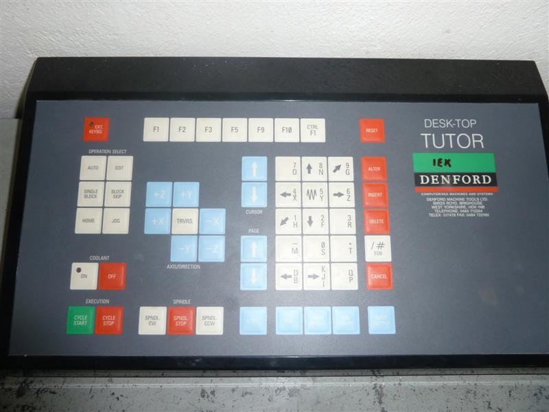

6) which desktop i use ??? ( see attachment) when i use P2 DESKTOP
As far as I know there are no switches to set or change

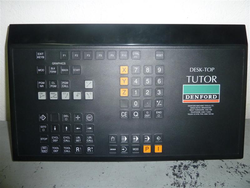

I'd forget about the Tutor for now and disconnect it completely - just get the machine working first
Use this post to operate the DOS software from a QWERTY keyboard
viewtopic.php?t=59
I think either TUTOR will work and they are just different key overlays - the black one will operate the Heidenhain software and the other will operate Fanucmd

i pullout the eurocard and put it back again , then i use FLSTEP with com1 only (QUERTY KEYBORD ) in fanucmtr software

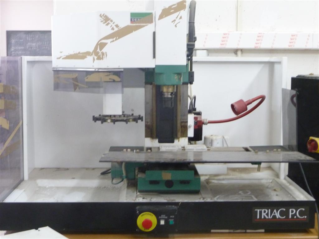

AND IT WORKSBUT the software is for lathe in the screen and i am connected with mill.
Then i can not control from keyboard the mill because the screen is in lathe mode , so WHAT DO I HAVE TO DO FOR THE MILL???
The only control from keyboard is <cooling on > .
what is the text .GO &.OPT for mill ???
