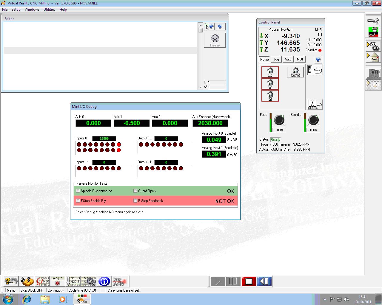

Run VRMilling, connect to the machine and goto menu "Setup > Debug machine IO" then locate the onscreen LED for input 7 (hovering over them brings up a hint)
Let us know if input 7 is made (lit up) and changes state when running > 500RPM

Pressing 'escape' doesn't work.
Up to 450 works, 550 and above doesn't.
Input 7 is lit up all the time (along with input 15) it doesn't change state at all.
See screenshot below.

It does now appear that input 7 has blown when the PAT test was performed.
