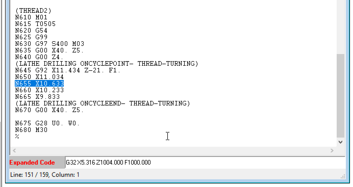

I'm currently trying to rewrite the Fusion 360 Post processor to correct drilling and threading cycles
Just trying to get G92 working and need to file a BUG in VR Turning, seen in v1.33 and v1.51
I'm only doing this in the simulator / virtual machine right now as I'm not near the our Novaturn.
Using the correct modal format and Setup->View Cycle Expansion shows the issue/
line N645 G92 X11.434 Z-21. F1. runs correct
but in the following line N650 X11.034 its is correctly trying to expand the cycle to G32 but has a Z10004 (way off the scale), and not correctly remembered from the previous Z-21
Screenshot 2020-01-26 at 14.33.13.png (33.32 KiB) Viewed 36384 times
