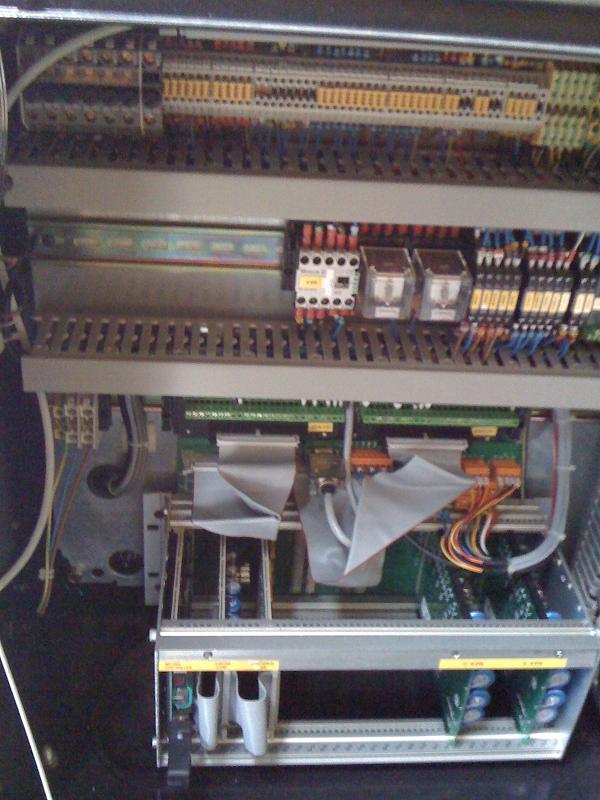

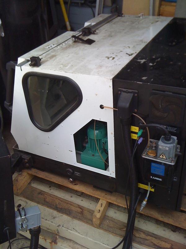

I have the below machine in the pics and i do not know anything about it. My boss at the company i work at bought this on Ebay or somewhere like that and it came with everything seen here.

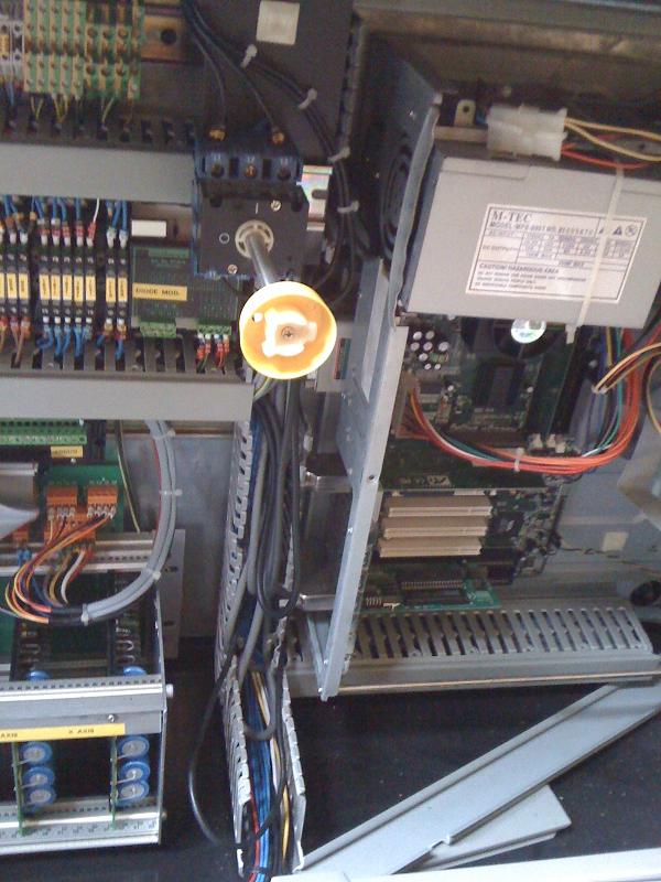

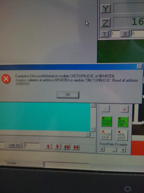

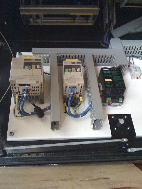

When i first powered the machine up Win98 would boot and appear to be fine. I was able to double-click CNC Turn and it too seemingly worked fine. I could not jog the X or Z nor could i jog the spindle. I could however jog the spindle by pressing the manual button on the spindle relay. Both OMRON drives(tool changer and spindle) look to be functioning correctly, the displays have numbers. the EUROSTEP Controller has an "L" and flashing period. According to the manual for the EUROSTEP the "L" means open limit switch and when i emailed Denford they told me it meant a communication problem. according to the 1996 electrical prints(found on this forum), if the limit sitches are activated the e-stop circuit will de-energize the ESR(e-stop relay). i checked the ESR and it functions correctly. then i tried and get the machine link in the CNC Turn software to "link" with the controller to check for communication and shortly after trying that a few times i got the below error message. Now everytime i start CNC Turn i get the message no matter what i do! after pressing "ok" on the error message CNC Turn shuts itself down. i have tried this numerous times with same result.

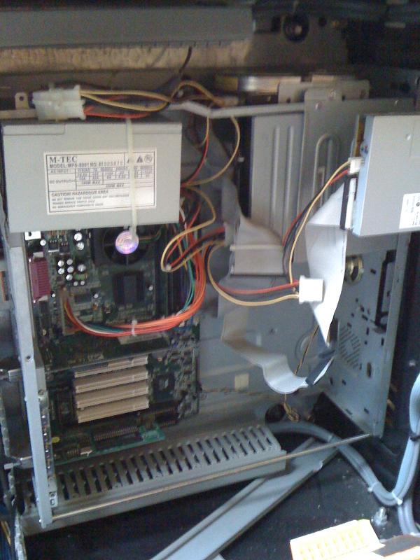

Now im dead in the water. im going to take the PC out of the machine and have my IT guy check everything out(serial ports) and make sure the computer works correctly. i will also check all communication cables to see if continuity exsists where it should according to the 1996 electrical prints.

I don't know if we have a copy of CNC Turn at Denfords but it may be worth reinstalling it. The Denstep card will show a "L" until communication is esablished.

Sorry, i forgot to mention that during the emails to and from denford i asked for a copy of CNC Turn and i was told that it is not a denford product and that CNCTRAIN is the people to see. so i emailed them and they just told me that i should download Workbenchv5 from the baldor support website and try that. they also said to check CNCzone to see if anyone has got Mach3 to work with a denford machine.
Mach3 is mentioned alot in many forums, is this somthing to consider?
My software is dead, so im trying the workbench, since its free, and go from there. I will post back shortly with results.

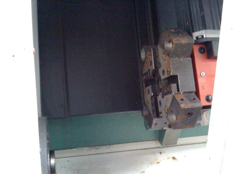

works now! i feel like such an idiot! heheheheheheh the machine can jog X and Z and home the axis's. i can mdi the spindle and it works. theres only two more things i need to figure out... the tool changer doesnt change and the Tutor Keyboard doesnt work. but ill figure those out later. now its time to build a bench with wheels for it. i will eventually make an automatic clamping collet chuck with 36" capability.

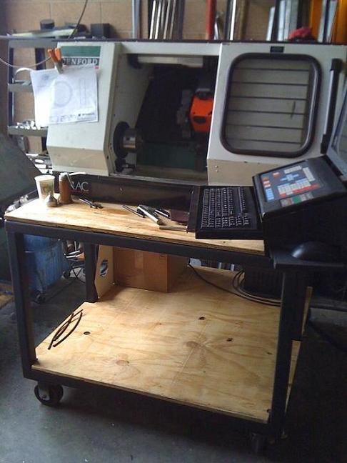

I've built a stand for it. Now all we need to do is set it up and start making parts (see attached pics).
