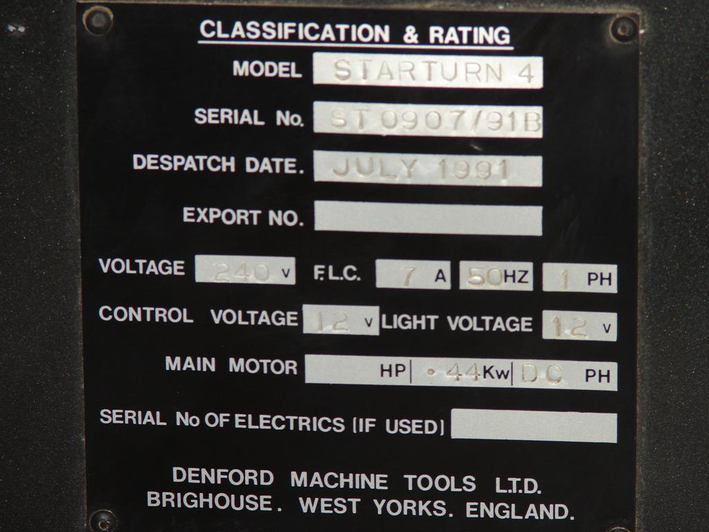

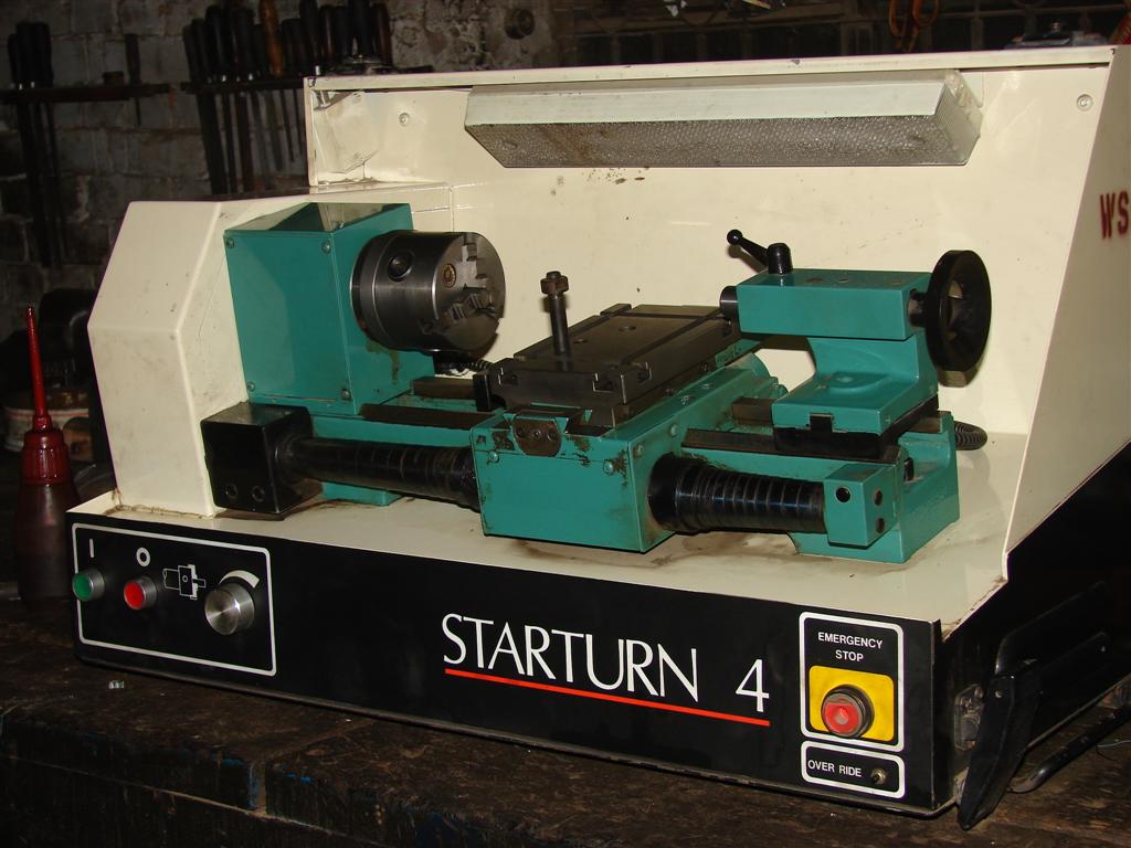

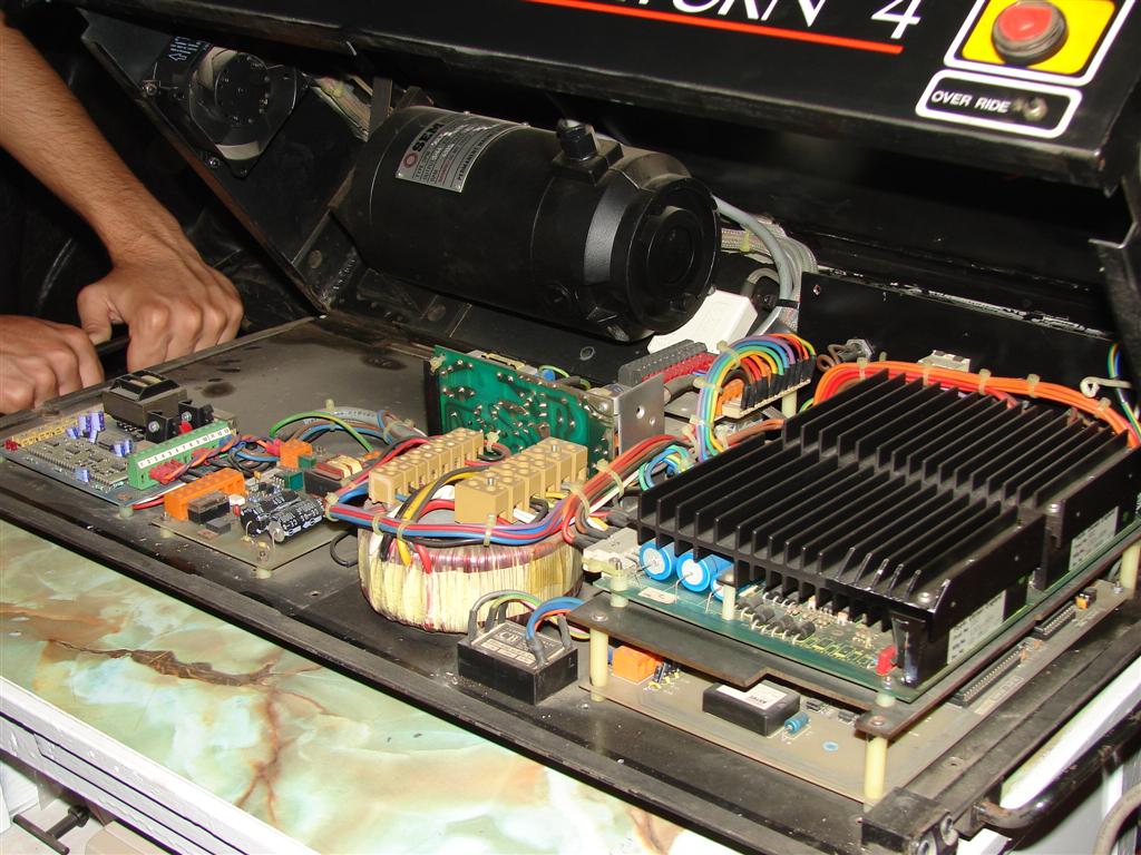

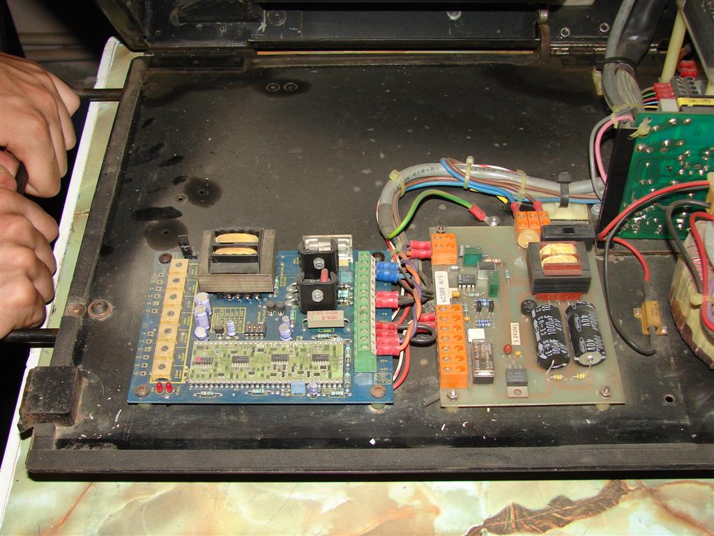

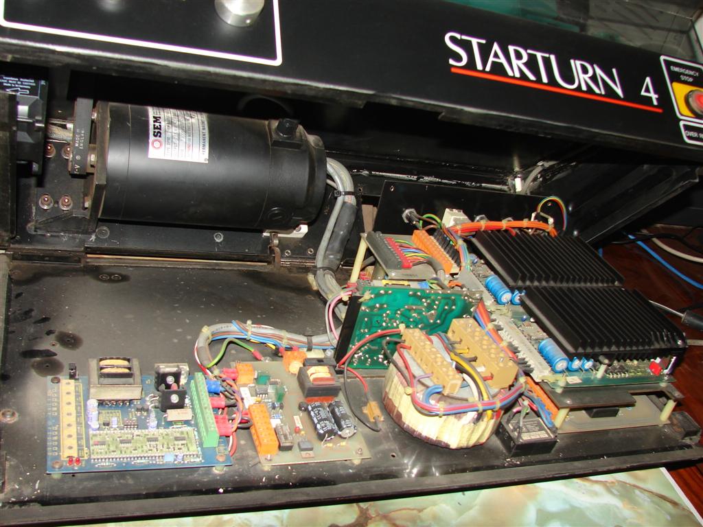

Can you provide more info and photos ?
As far as I know your Starturn 4 could be very old BBC micro, apple II or IBM or could be Baldor with DOS sw or it could have been upgraded to Mach or anything else.
Re: Need drivers
Dear Denford Admin!
Attached are the images of my STARTURN 4 as per your instruction.Your good self is requested to resolve my problem at your earliest.I can also provide images of the circuit inside the machine if you require.
Hoping to promote good business relation with your esteemed organization.
Best Regards
Suhail
Re: Need drivers for a Denford Starturn 4
I'm 90% certain this machine was controlled by an IBM PC or BBC micro.
Your only hope is that the electronic control card is one of the first LCB 3 boards and this may then run from fanucsld
If it's earlier than that then we don't have the old IBM or BBC software

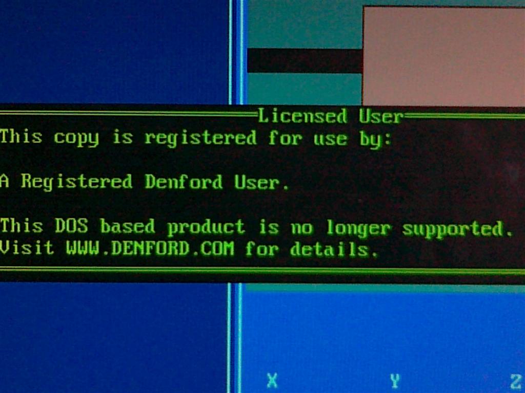

Can you post a photo of the screen message ?
This DOS product is not supported does not seem like a message from our old software - ie, how would it know it's no longer supported ?
Dear Admin!
Attached is the image of screen message as required. You are requested to resolve my problem at any cost. For this, you can discuss it with your team.
Actually, I am a student of 10th class. My father gave a reword of Rs 200,000, which is equal to 2325$ because in my examinations I have gained good position. I decided to purchase nothing but your two noble CNC (used) machines “Starturn 4 lathe and Triac VMC milling. Both machines were without software and are in good condition. Before purchasing machines I hoped that I would get the assistance from you.
Several months have been past but still I am not able to run them. In this grave situation I could not face my father due to the wastage of my money while purchasing worthy machine with no use.
You are once again requested to solve my problem or send me some poison but don't say it is impossible for you.
Yours truly,
Sorry I didn't see you'd already posted a screenshot !
I'm sorry for not noticing this earlier - the message shown is what is in the flash code:
"A Registered Denford User. This DOS based product is no longer supported. Visit WWW.DENFORD.COM for details." is the user name in fanucm.opt
So, the software is saying it's OK and registered to "A Registered Denford User" - can't you press a key (eg escape or enter) to continue using the software ?
