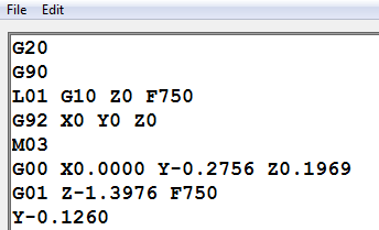

I am using QuickCAM 3D version 3.70.70 to convert stl files for my Techno Patriot 1410. I'm using Techno CNC Interface version 1.421.29. When I export the file to the Techno-G-Code, it puts some extra at the beginning of each file. It is consistent. I am only cutting out F1 body blanks in this router so I would want the files to be the same every time.
I need to delete lines 4 &5, add M03 and change both F values to 700. I also add M05 after the last line of code. This is something I do with every file.
Since I am just cutting F1 body blanks on the Techno Patriot, is there a way to change the Techno-G-Code so it will process that for me every time instead of me changing the file?
Original code
Original code
Changed code to the way I would like it (except a feed rate of 700 instead of 750)
