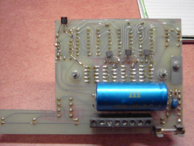

A photo of your board would be useful just to confirm its spec - in case it's another variant not seen before!
But on both boards shown in the thread that Admin suggested, the left-hand pair of connections (as viewed in the photos on the solder-side of the connector block) are for power. You should be able to trace the tracks to 4 diodes or a rectifier.
The next pair in are the sensor.
The last four are for the LED's - as can be seen by following the tracks through the voltage drop resistors.

Hope these photos help
Re: Wanted wiring diagram for GSM PC 1001/F speed board
Thanks for the pix - looks identical to the 'type 1' photo in the other thread.
So connections are definitely as given above.
