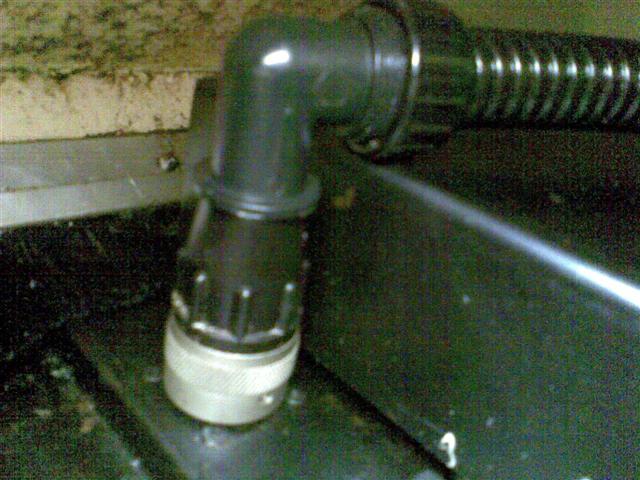

We do often get alarms saying Turret overheat, but all thats required is a quick "Twiddle" with the cable plug located at the top of the Z axis, from the 6 station Barrifaldi, to cure this, so we put this down to a poor contact in the plugs socket. Lathe can run for a considerable time before it re occurs.
Another question is, how on earth does that plug come apart? Its an RS plug with multi pins that connects the turret to the machine, we wonder if there is a broken wire in there.

Tried again tonight, still no joy. Holding the cable, connector pictured, the turret did try to unlock once using the front panel control and green button.. Noticed the turret motor is warm to the touch in less than 5 minutes.

RS connector: Turn silver ring to unplug and the insert which holds the pins will unscrew from the body of the plug, this will twist the wires though.
It looks like someone has screwed (or glued) the entry to the plug housing and fitted a flexible conduit gland and is going to be difficult to remove without going for it and chopping the wires and re-making the plug.
