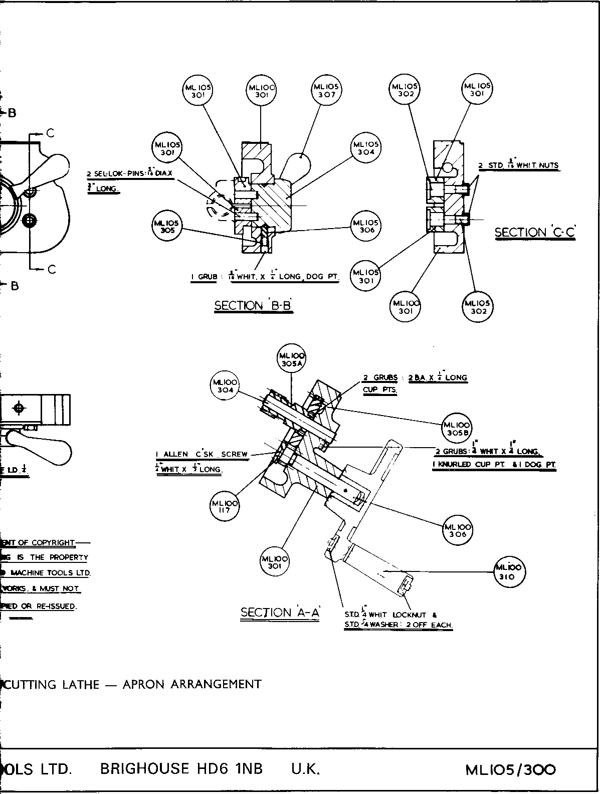

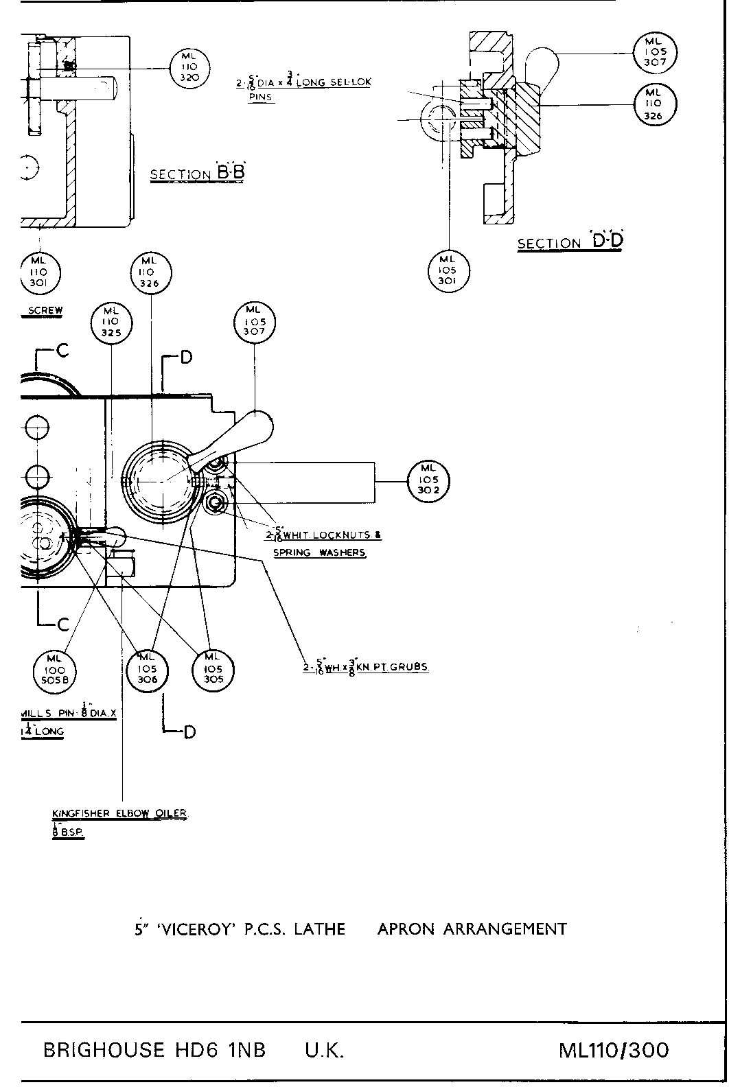

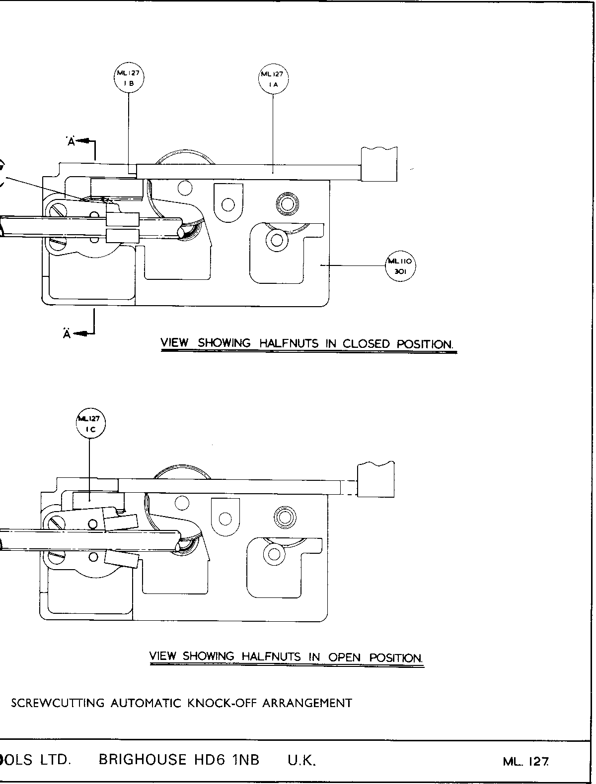

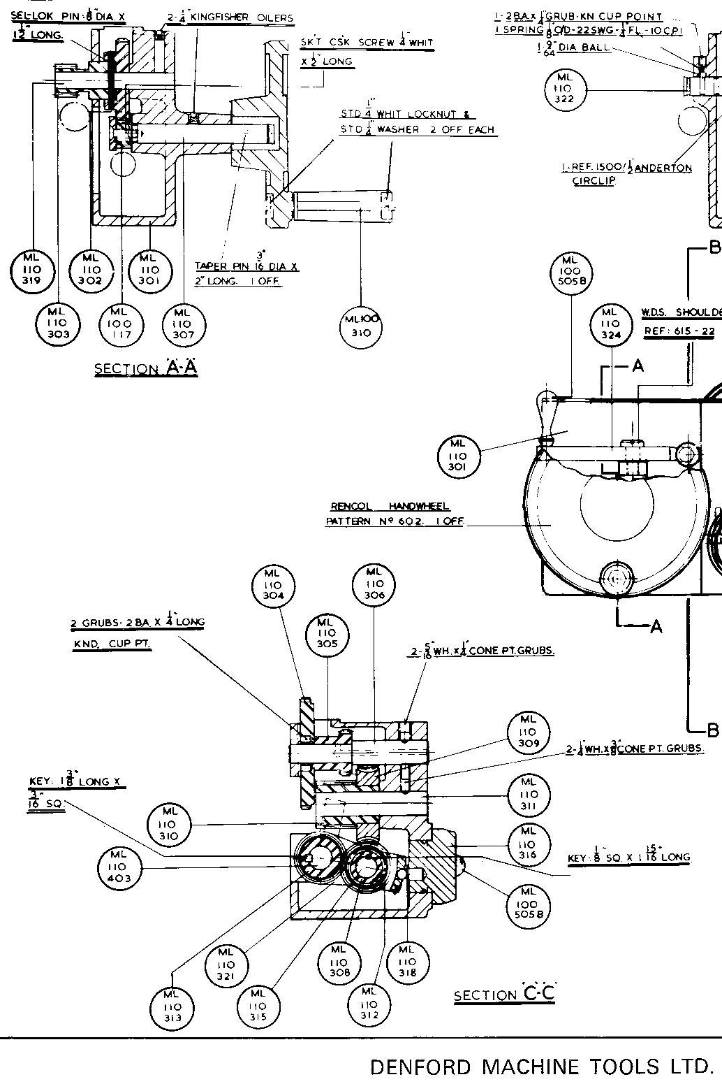

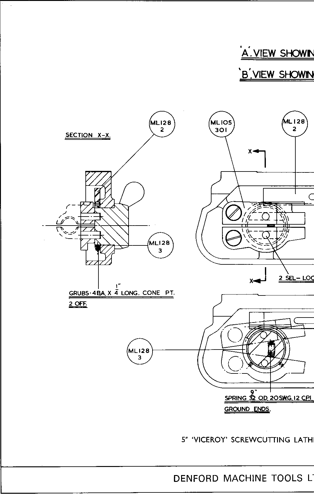

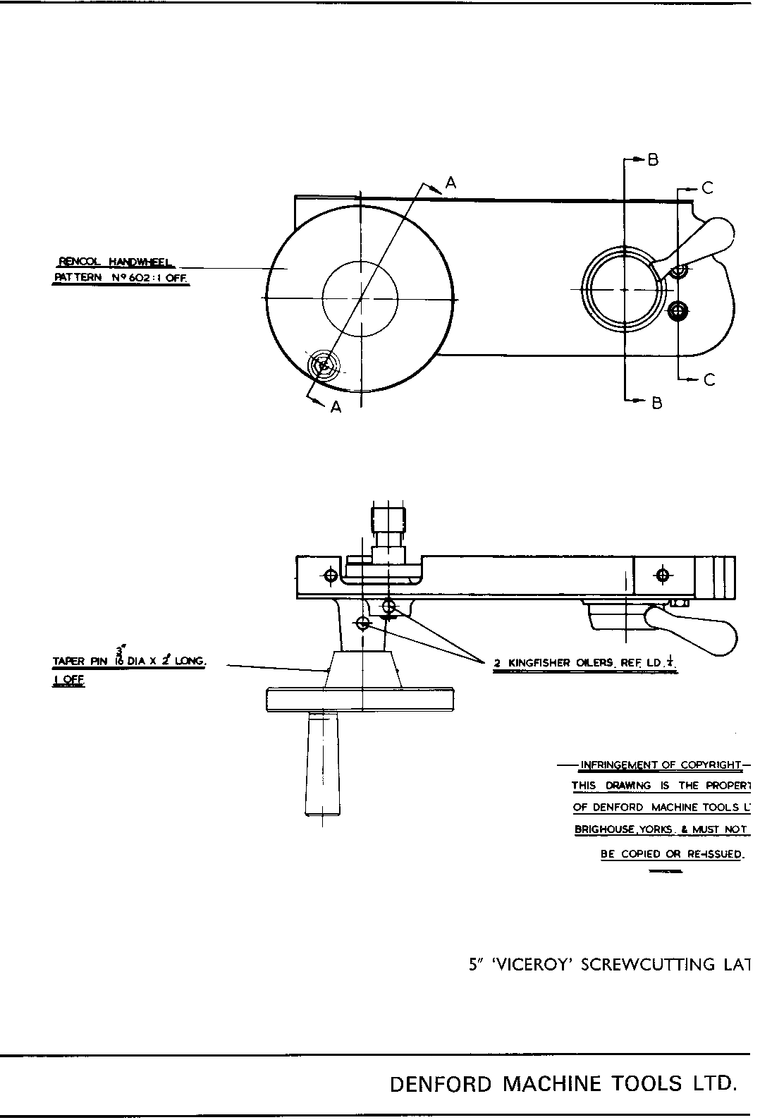

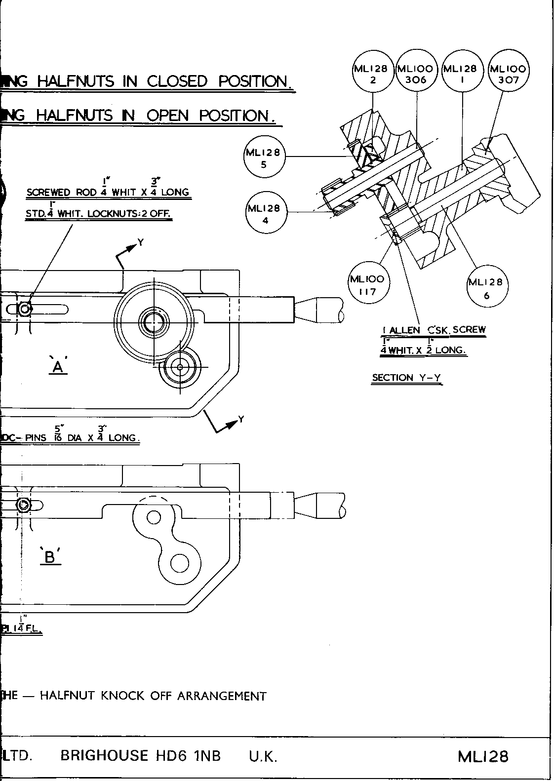

I have scanned some drawings which might help you a bit.
Cheers,
Les.T.
PS as before they are A4 scans so if a helpful person could join them that would be appreciated.
