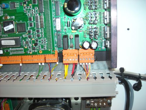

I rechecked the fuse and it was OK. If I am doing this correctly, I am reading 25 V DC across the red and black wires under the fuse. I am not getting any readings across the two yellow wires under the fuse. I added a picture of the wires that I checked.
Am I on the right track? What should I do now?

Have you still got an Emergency Stop Error on the software ? if yes, it seems the Emergency Stop Relay (ESR) is not activating, if it is not activating, then it could be the E-Stop button / contacts are faulty. If the ESR does not activate then it does not close the contacts supplying power to the Drive input terminals (2 x Yellow wires). See drawing

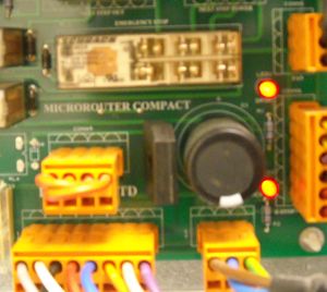

The relays in the picture all move when the estop is pressed and released. If I am correct, that should be telling me the Estop button is working. Am I looking at the correct relay? It is marked Emergency Stop.
What should I try now?

The long oblong block is the Emergecy Stop Ralay (ESR), if this is working correctly as you suggest, then it should have closed the 2 x ESR contacts (12, 24) and (34, 31) and you should have power on the NEXT STEP DRIVE terminals 1 and 2 (2 x Yellow wires). If not it looks lile the ESR is faulty i.e. one or both of the conntacts are not closing when the ESR is energised.

When I took the picture of it last night, the relays were closing and opening. When I tried it this morning, they worked one time and did not work the next 5 tries. So the Estop button works intermittently. The router runs when the Estop works. Thanks for your help and explanations.
Should I look for anything special to replace the Estop button other than getting one like the one that is in the machine?
