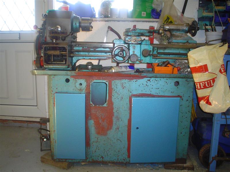

the lathe resprayed the doors hammered enamel

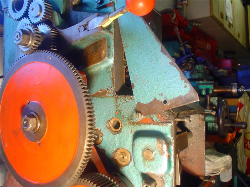

viceroy lathe 004 (Medium).jpg (71.31 KiB) Viewed 5935 times
no gears
no gears

Re: lathe missing shaft and gears what parts do i need
I think you may have a bit of a problem.
As far as I can see you have a slightly different version of the gearbox shown in the scans.
The bits you need look to be shown on section E-E.
There are item drawings available as Pdf's (look for the ML115 section),
but as to how to make or get any of these items,
I think that could be a bit difficult.
Good luck anyway.
Cheers,
Les.T.
