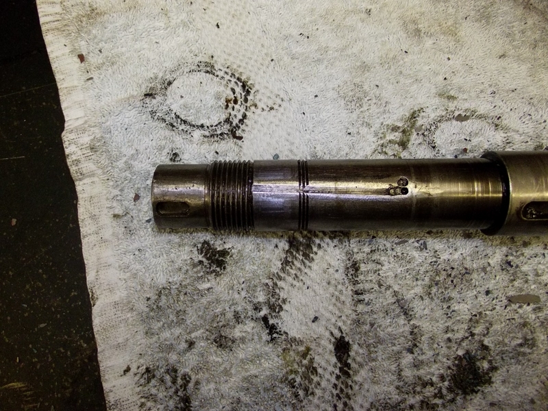

The main reason for my griping is the headstock assembly, everything else one could put down to wear and tear, but if I can get some images up for you to look at, you'll see what I mean, but I'll describe it, the underside of the headstock casting is cracked across a corner, the narrow bar that acts as a locator with 2 dowels in it, is cracked across both dowel holes, the main spindle has been hammered at the gear end to try to remove it, then filed down - yes filed, where the rear most inner collar with 2 grubscrews sits, there are long scoring marks on the spindle, where removal had been tried without undoing the grubscrews, then filed down........
I don't know what else we might find wrong with the spindle, but we're off to a professional welder with the headstock, to be properly cast iron welded.........

Is that a left hand thread on the end of the shaft ? - I bet that caused them some frustration as well :shock:
Re: Caveat Emptor TDS 1/1GB
Yes,Yes and bloody yes...........

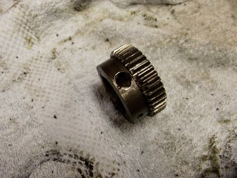

I think I'll end up making a new spindle for my son, along with the end gear, that's also damaged, I'm also making an imperial cross feed screw and nut for him,
when we get the headstock casting back it'll want truing up, so there's aplenty to do.......
I made up this tool quickly to reduce the accumulated damage, to pull the end gear off, I had assorted lengths of threaded rod and spacers, here's one I made earlier.......

Looks like someone's been hammering on that gear to try to drift it off :(
I like your fittng for the hydraulic puller - very tidy.
