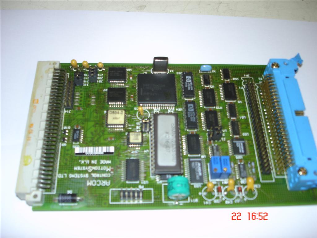

Can you also post photos of the card rack and close-ups of the cards - there may be something missing

enclosed are pics of boards in and out

Does LD1 on the backplane inluminate?
Re: mint card
no it never has.
Re: mint card
The seven segment LED (LD1) on the backplane should display a "L" when the ste motion control card is powered up. Can you check that the small (ten pin I think ) ribbon cable is pluged in to the ste motion control card & the back plane. If it is & it does not function then you may need to look at the computer power supply. It may be worth trying the motion control in the spare slot to the left if you can.
Re: mint card
we have made sure the 10 pin is home properly and have also teted th ribbon cable
there is still no led
we can`t fit the board into the spare slot as the computer card ribbon bracket fouls on the motion card
the psu power supply is showing =12v -12v and 5v
the computer is powering up but only to that error stage
colin
Re: mint card
How about removing the pc card to gain acces?
If the STE Motion Control card does not power up then the software will trip out.
Re: mint card
Does this mean the ste board is faulty as the led light on the backplane does not illuminate ?
if there are no replacement boards available is there an upgraded board available ?
