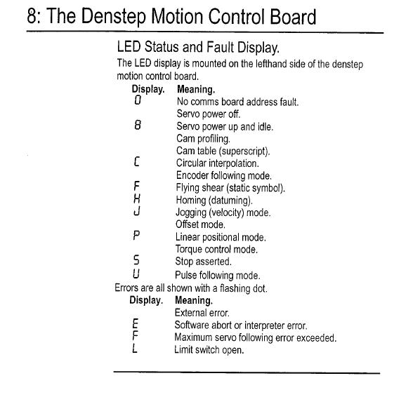

Denstep 7 Segment LED status and fault display
Denstep 7 Segment LED status and fault display.JPG (43.75 KiB) Viewed 9007 times
Re: Denstep 7 Segment LED status and fault display
Denstep 7 Segment LED status and fault display in PDF format
Denstep 7 Segment LED status and fault display.pdf
(55.66 KiB) Downloaded 1593 times
Nb, an L on the display also means that the Mint file needs 'L'oading
Our machines would not normally show L for limit switch open because we've never used that feature.
