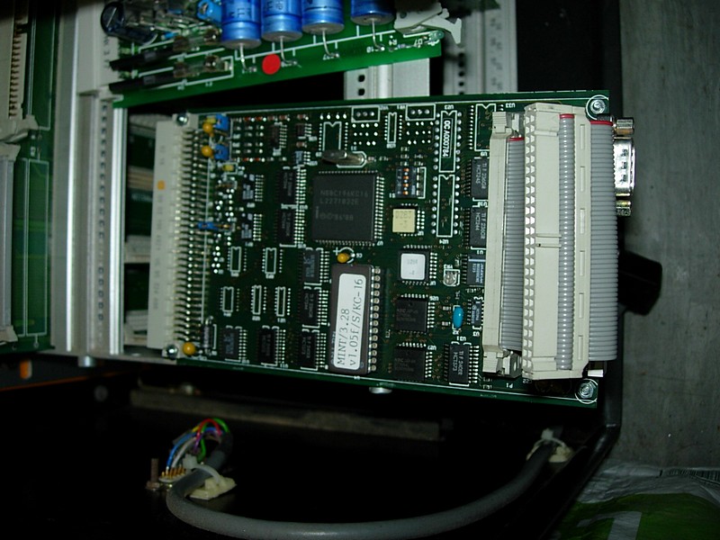

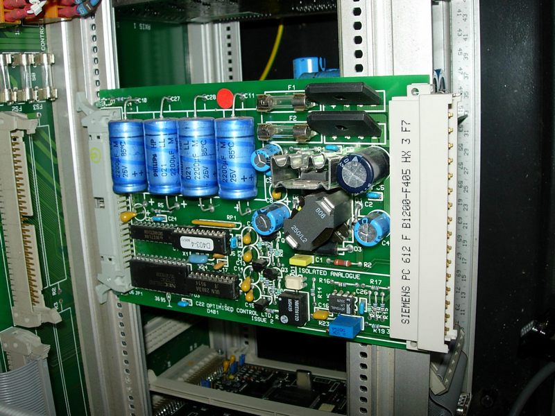

You'd have top confirm the control type - upload a photo of the electronics...
Re: Modernising a TRIAC
I send a photos of electronics my machine.
Hi Maciej
Yes your Triac Pc will upgrade using the UGR0007 kit.
The kit includes a rack controller card plus internal USB plug & cables & VR CNC Milling 5 software (single seat)
It would require a hole in the side of the cabinet for the USB bulk head fitting & may need the speed & feed overide pots changing to the 5 Volt supply (originally 12 volts if fitted)
