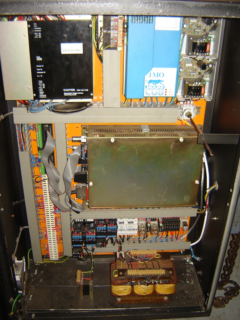

Heres a pic- Mike
heres inside controller cab at rear
Quatro board .jpg (490.55 KiB) Viewed 44673 times

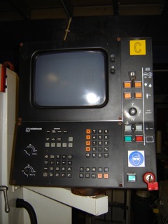

Heres controller-
Heres controller-
quatro heidenhain .jpeg (26.05 KiB) Viewed 44673 times

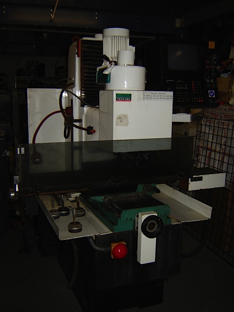

heres main machine- Mike
heres pic of mill-
heres pic of mill-
quatromill full pic.jpg (82.35 KiB) Viewed 44673 times

It looks like it's got Norwin DC servo drives.
The Heidenhain (TNC 155 or TNC355?) was definately a closed-loop position control, so there should be motor+tacho back to the drives and position encoder feedback to the control.
IMO any upgrade to Mach or similar would be pointless / a step backwards
I'd have a look at the control manuals:
viewtopic.php?p=3945
viewtopic.php?f=15&t=2256
and have a play around with Dialogue programming and see how the machine performs.
There's a lot you can do on the control itself, with a little bit of programming. The heidenhain dialogue format was pretty easy to use once you got the hang of the keyboard input
Once you have the machine working and need to make more complicated stuff, most CAD/CAM programs will post output to Heidenhain Dialogue format - if not, the control will accept ISO G-code as well.
