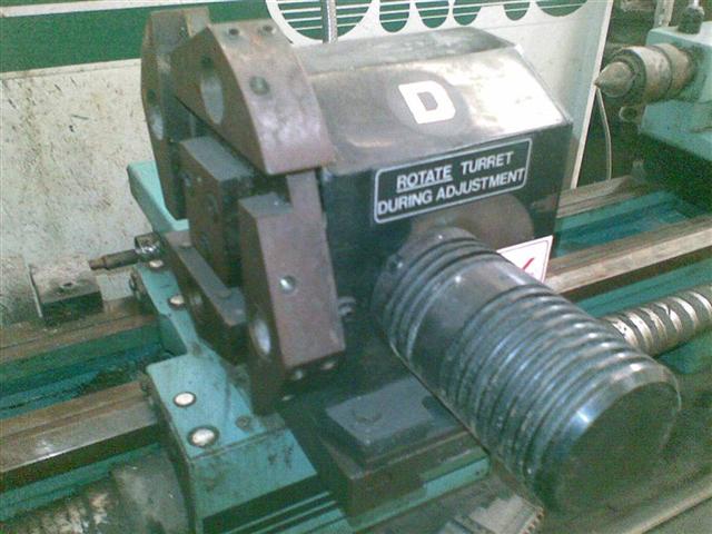

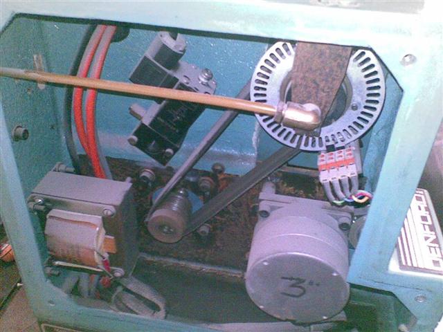

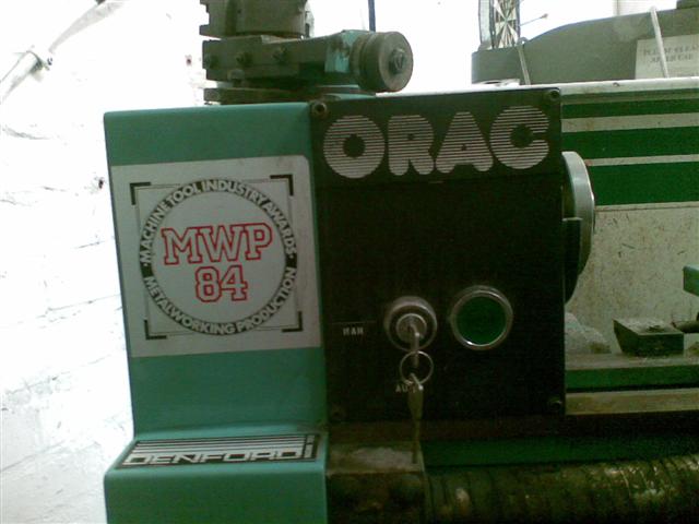

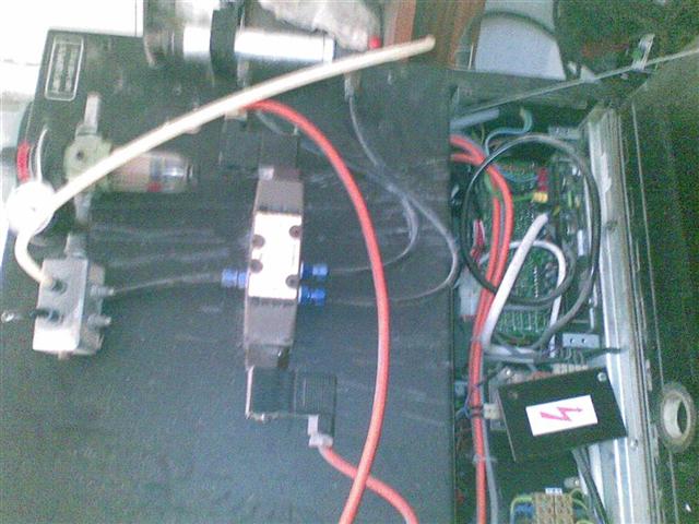

Re: TDS/C/R/CNC (Feb 1985) Lathe - Speed control problem
What is a TDS/C/R/CNC?
Is it an Easiturn / Micromaster?
Picture of the machine might help to at least find manuals / schematics.

ORAC
