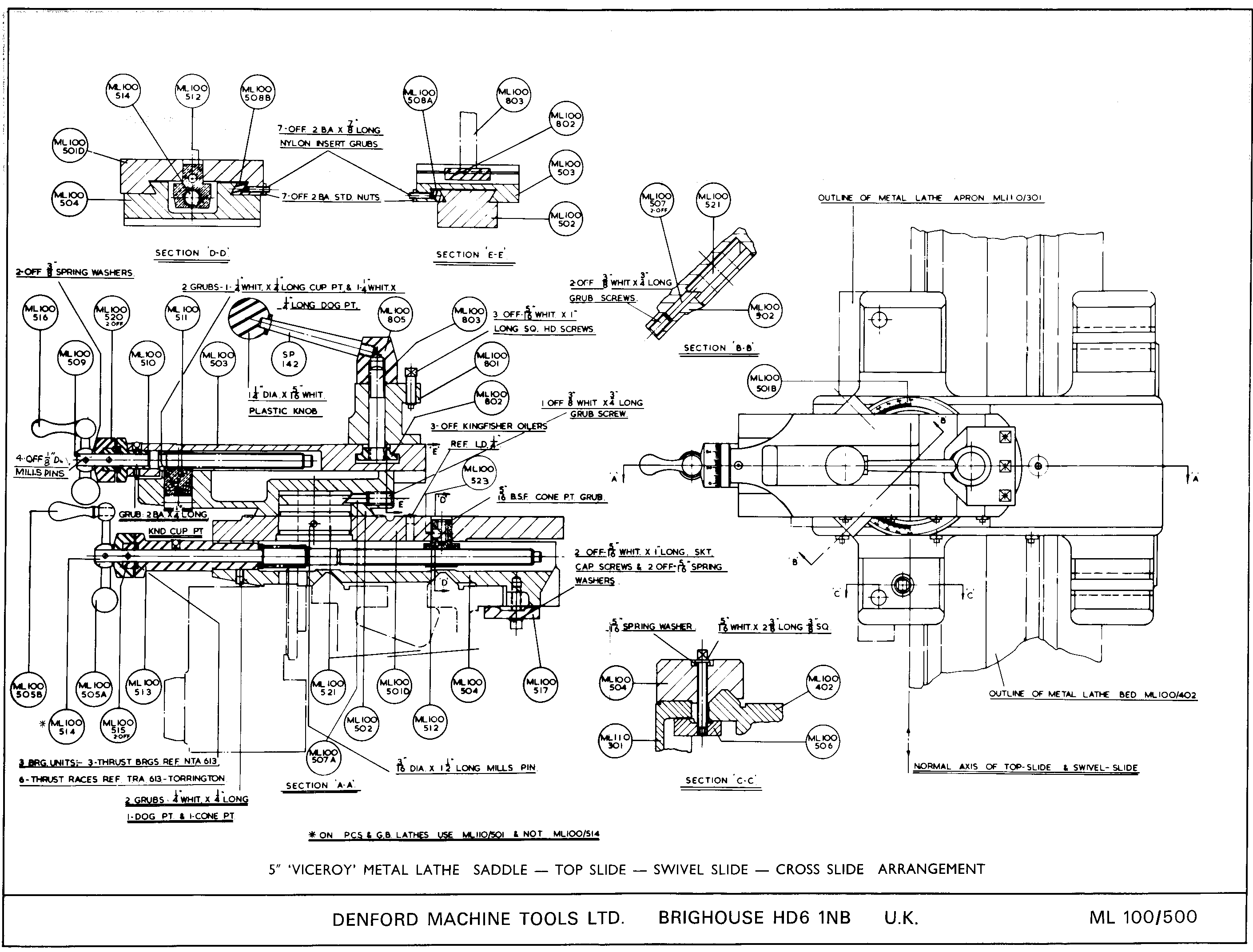

ML 100/500

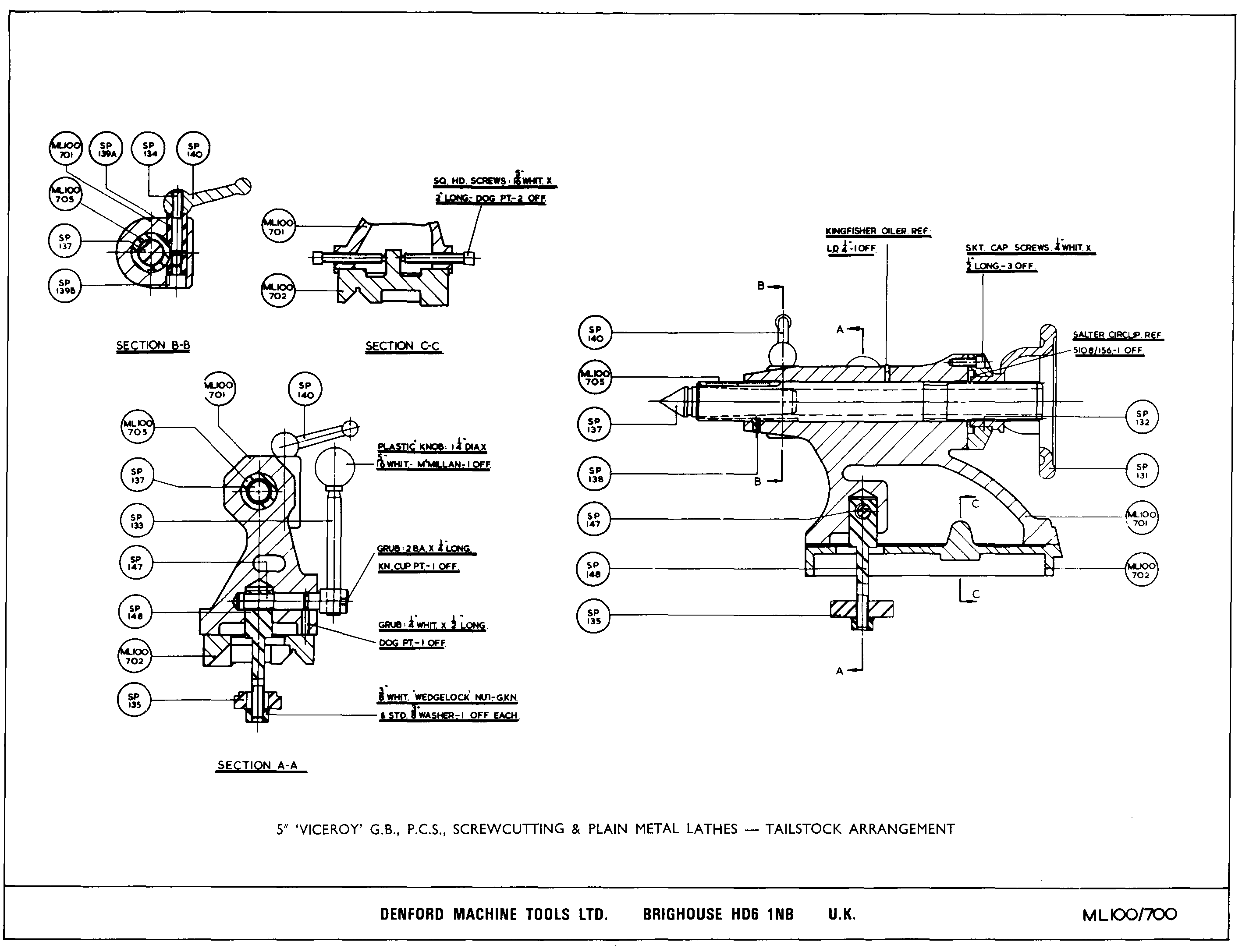

ML 100/700

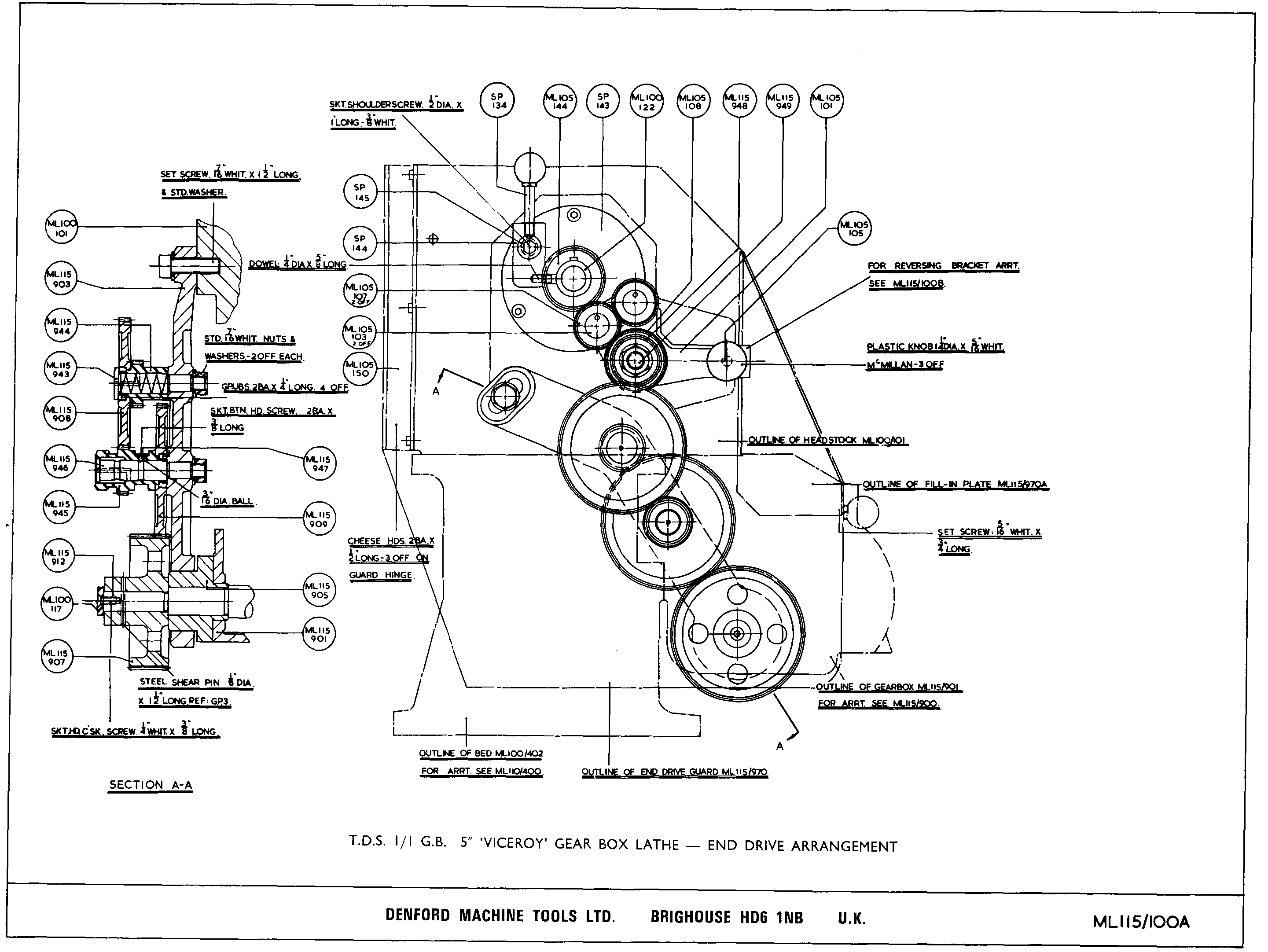

ML 115/100A

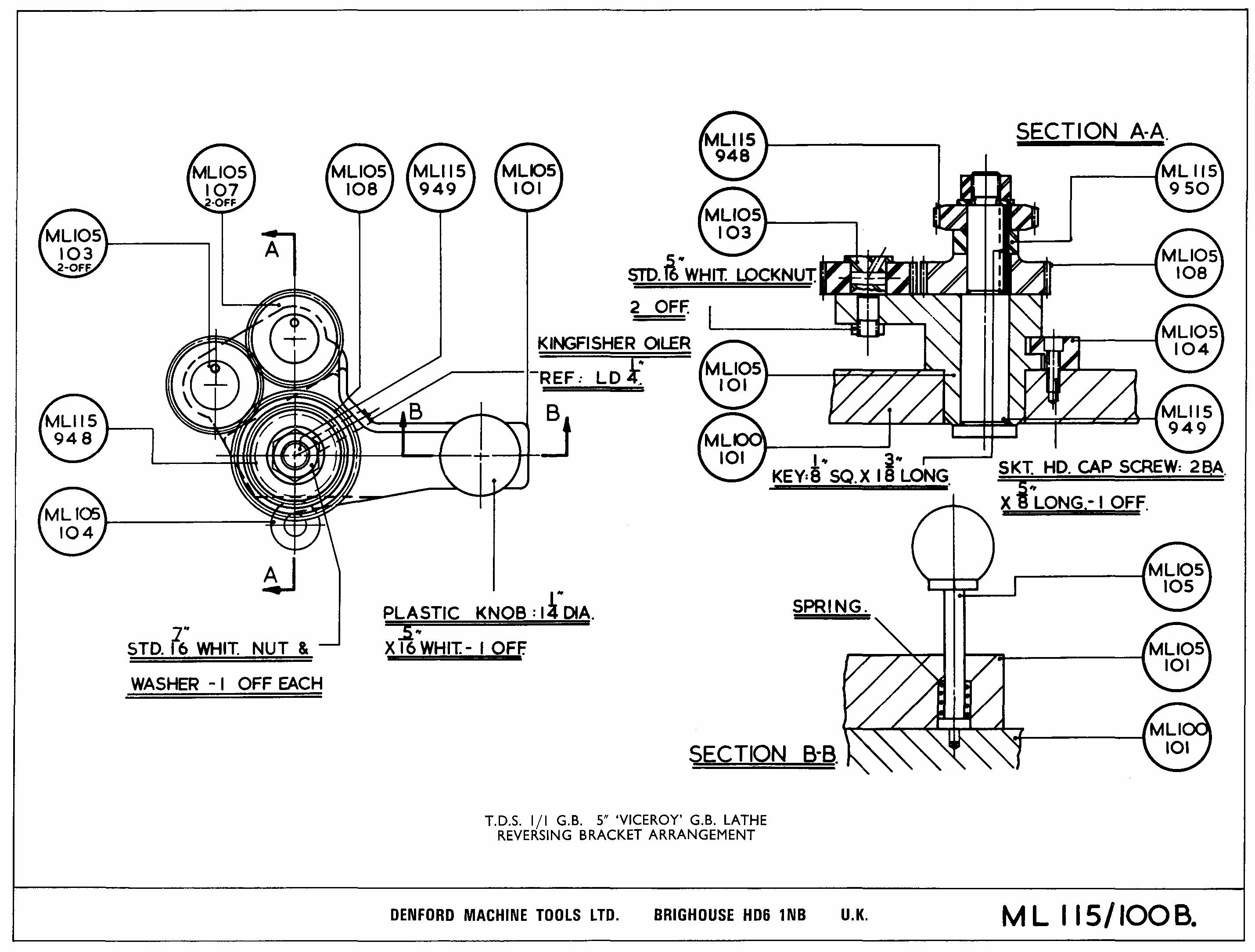

ML 115/100B

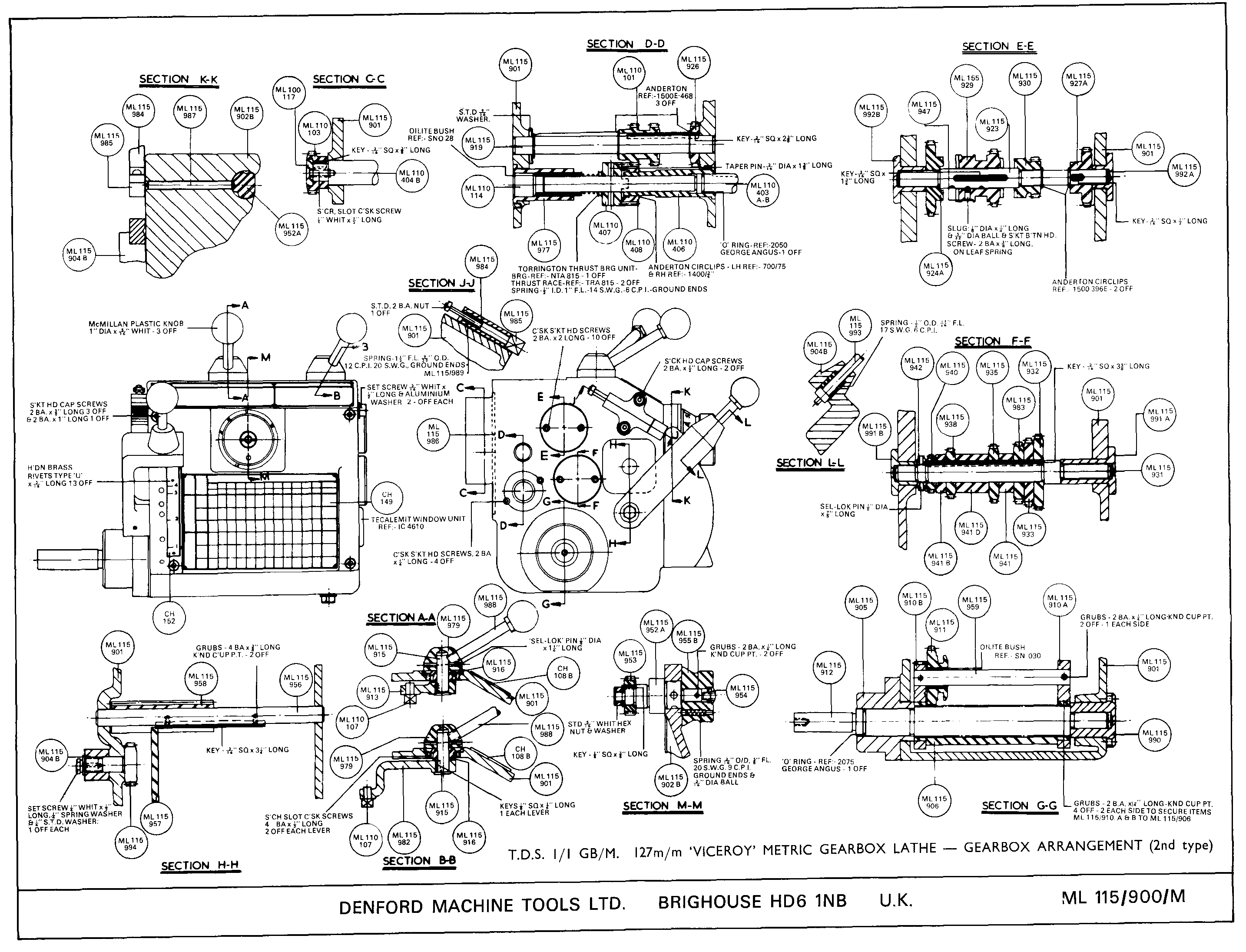

ML 115/900/M
