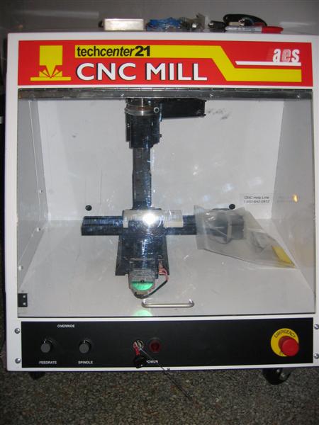

I have a Micromill 2000 and I need wiring diagram for ON key and the OFF button (with light). All of the wiring diagrams I have found on this forum do not have ON key and the OFF button (with light) setup, they all have the ON key, but the OFF is the E-Stop button. The off button on my machine would light up when you turn it on, and shut off when you push it in to shut the machine off. Any help would be great
Front of my machine
Front of my machine
DENFORD (18) (Medium).JPG (43.08 KiB) Viewed 7618 times

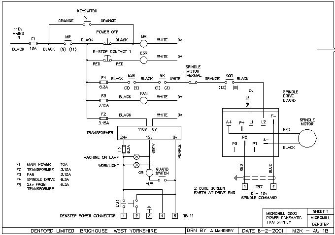

I hope this drawing is of help
Micromill Power Schematic US 110V.JPG (54.37 KiB) Viewed 7612 times

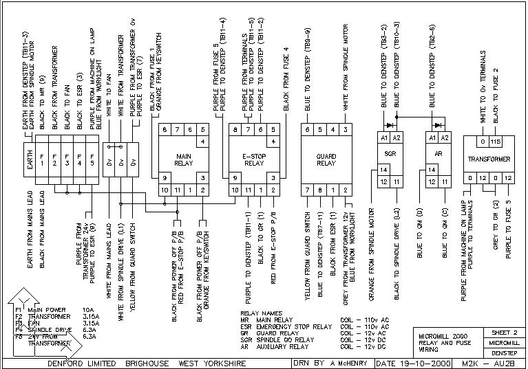

I think this one will help a little, but is there a drawing for how they are connected to the relays. Thanks
Re: Micromill 2000 wiring diagram
Hope this one helps
Relay and Fuse wiring.JPG (98.18 KiB) Viewed 7607 times
