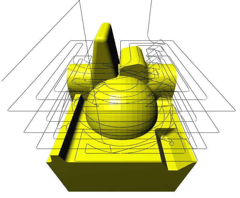

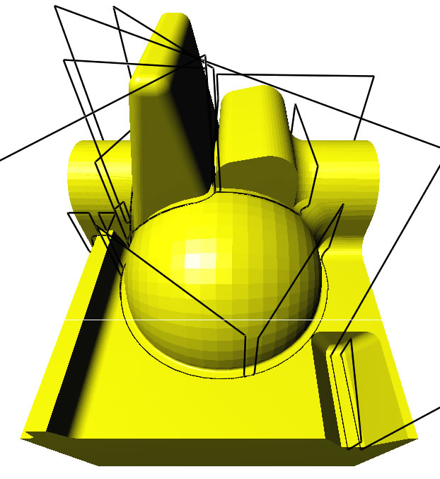

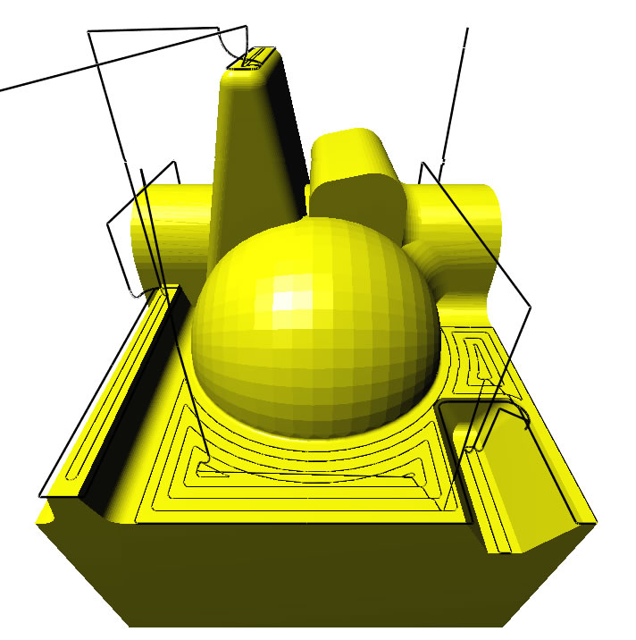

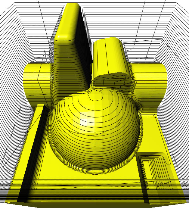

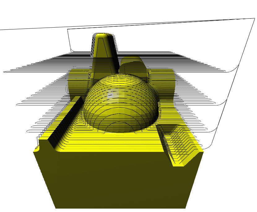

The pro version has more "fancy" machining types available:
Raster roughing and finishing.<br />Also includes a raster + waterline combination plan
Waterline milling
Waterline milling
Pencil milling
Pencil milling
Parallel Pencil milling
Horizontal Area Clearance
Corner offset
Corner offset
Constant Stepover
Constant Stepover
Area Clearance
Area Clearance
