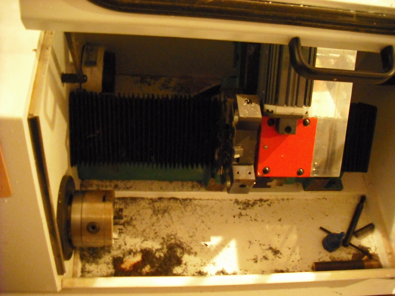

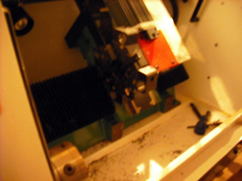

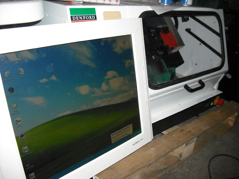

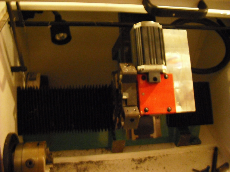

Thanks for the advise. Heres a few pictures of my machine, there not the best as my camera was going flat so my flash wouldnt work.

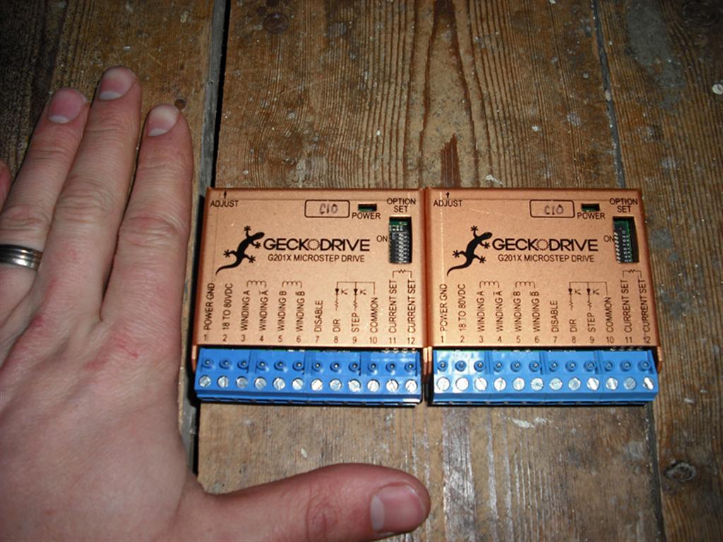

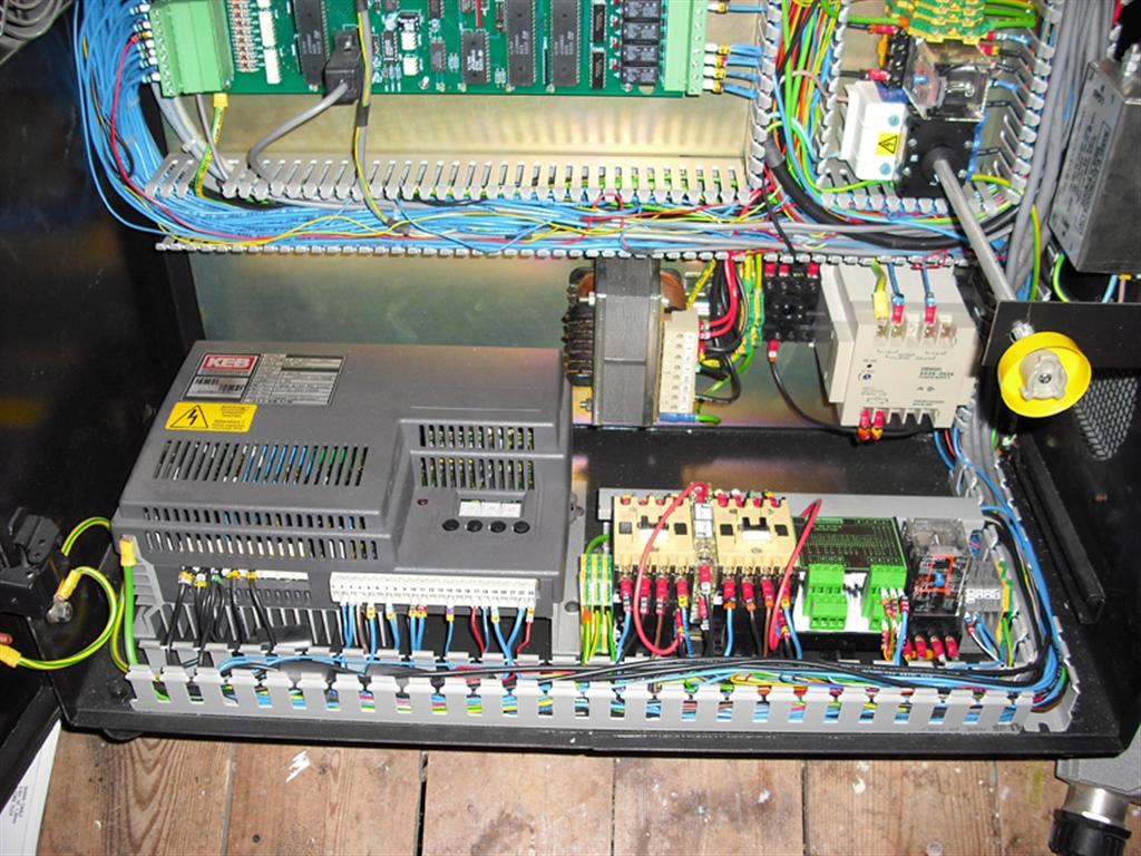

Today I brought the electronic control box home and got the geckos out of their packaging. I was quite shocked how small they are but they seem to be excellent quality. Gecko shipped them very quickly, I received them within 3 days all the way from the US!
Anyway I sat down with the control box and started working out what's what. I have identified the X and Z axis's on the slave board and also the drive supply. I has hoping to work out what voltage the steppers run at by measuring it from the drive supply connector but it seems it does not output any voltage when not connected.
Does anyone happen to know what cables go to what on these steppers. If not can I just work it out by doing a continuity test?
Just in case anyone is wondering the machine was made in 1995.
Heres a few pictures:
Re: Denford Mirac Electronics Refurbishment
Yes you should find two pairs of wires with the same low resistance reading.
I'd guess looking at the photos that if you take the wires off the orange connectors from left to right, you'll have your pairs 1+2;3+4 which will go to 3+4; 5+6 of the Gecko
