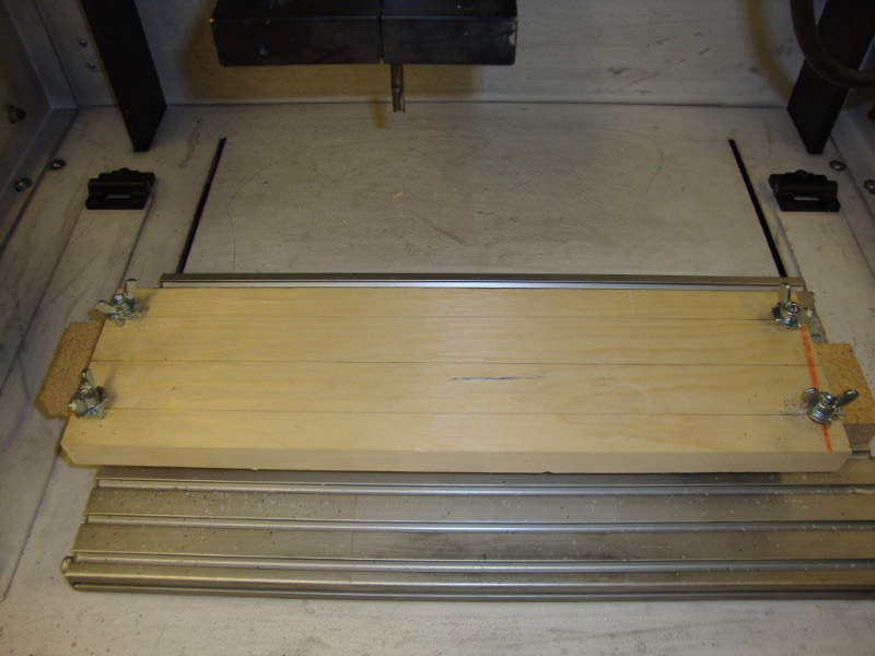

The next pictures show the material clamped onto the jig and then the two halves of the boxes machined out with recesses for the hinges and magnetic catch.
ready to machine.jpg (103.49 KiB) Viewed 11383 times

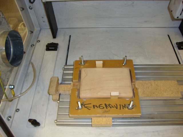

The machined part is removed from the jig and then hand finished as two halves.
Then another fixture is fitted to allow a design to be engraved on the lid.
This fixture is a tight fit on the inside of the machined pocket inside the lid preventing side to side movement, though a couple of wedges are used to hold it down.
lid fitted to jig.JPG (185.72 KiB) Viewed 11383 times
engraving jig for lid.JPG (201 KiB) Viewed 11383 times

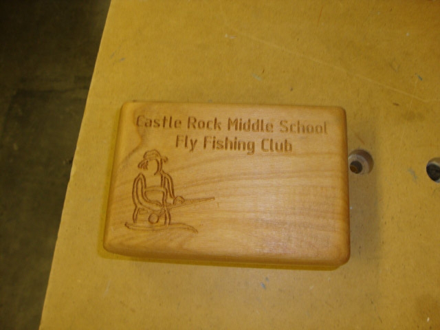

Re: Fly Box made on a Microrouter
Engraving the Lid
Engraved Lid.JPG (177.34 KiB) Viewed 11383 times
