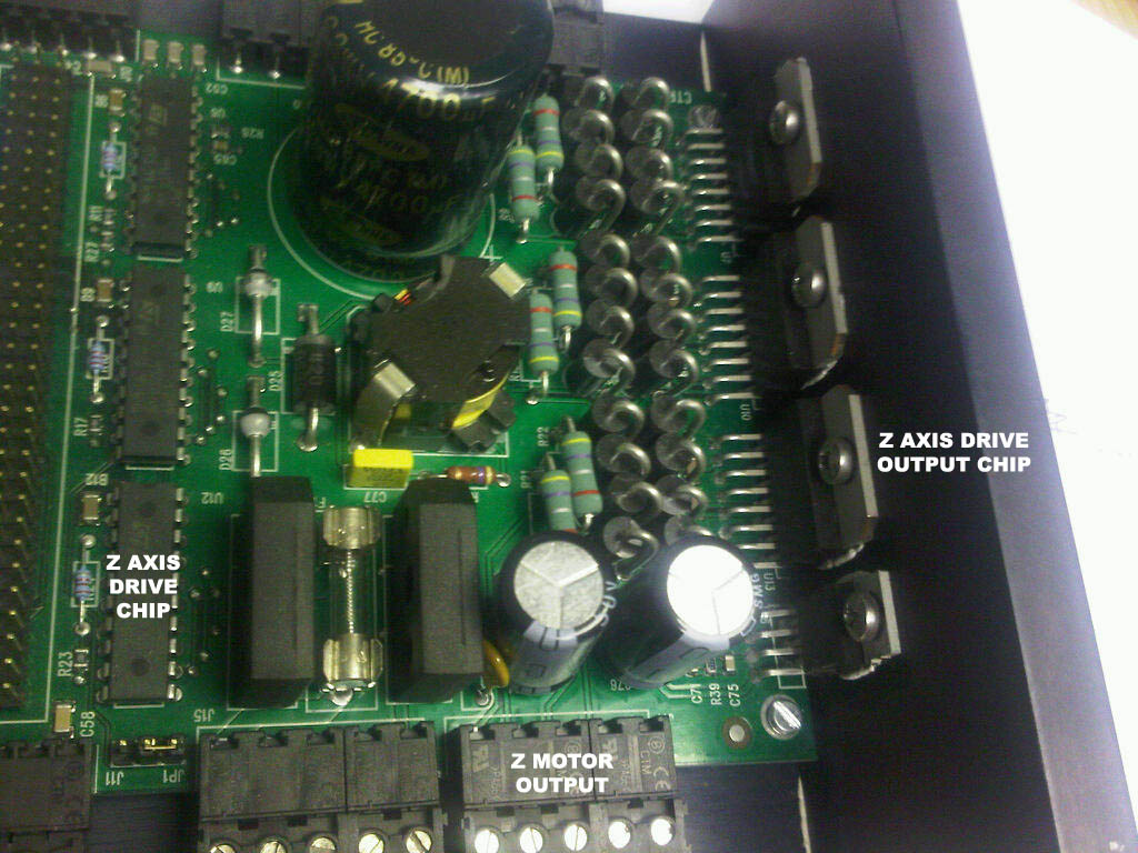

I attach a photo showing the devices.
You should be able to buy them from Farnell or RS
If you replace both it should fix it. :D
However if you attempt this and damage the tracks on the board then you will have to buy a replacement rather than get the service exchange as the board would then be unreparable. :cry:
The cost then would be £535 :loads-a-money:

Many thanks for the picture Steve, I was wondering which chip belonged to which axis.... I figured it might be those 2, but wasnt sure. - That helps a lot with which ones to take out and change first.
I'm just getting my old man to order the 2 chips on the company account.... Hope it works! - Are the diodes also a potential fault or is this a red hering?
Rob
