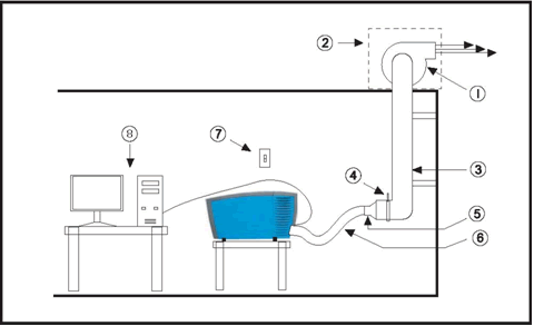

The following diagram shows a typical exhaust system layout. Use this as a guideline to proper exhaust system installation.
NOTE: Although this diagram just serves as an example, we recommend installation of the exhaust system by a local, licensed contractor to meet safety and local code requirements as wellas being able to calculate the correct size blower required for your particular installation. Length of exhaust pipe, exhaust pipe diameter, number of 90-degree angles, and other restrictions must be calculated when determining the correct exhaust blower unit. Installing an undersized or oversized blower is not only unsafe, but it can also lead to premature and excessive wear and tear to the laser system as well as premature failure of the blower.

1) High Pressure Exhaust Blower
2) Weather-proof Cover
3) Rigid Ducting
4) Airflow Gate
5) Reducer
6) 3 inch Diameter, Industrial Grade Flexible Tubing
7) On/Off Switch
8 ) Computer (user supplied)
