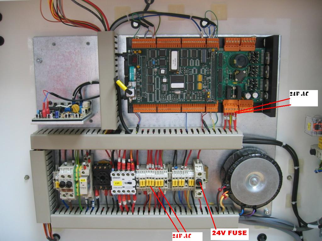

MicroMill 2000 circa 1999-2004 Schematic and Photo
The MicroMills of this eara were built in the UK.
They are fitted with a Denstep control Card and have the Power Reset electronics built onto the side plate
24v AC marked.JPG (121.85 KiB) Viewed 7603 times

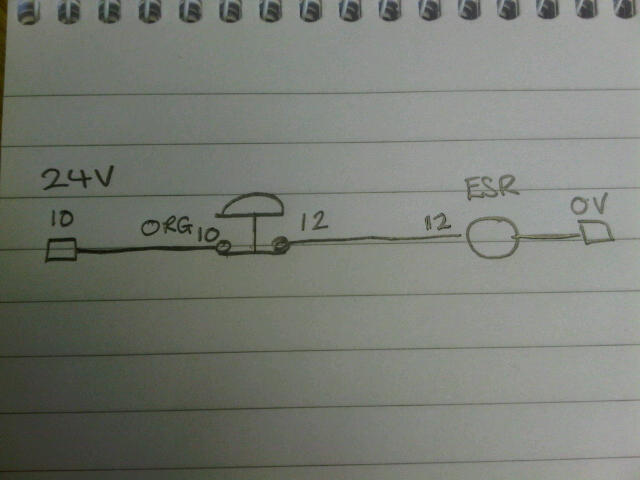

Customer writes:
Hi, trying to get software to work running Micromill 2000 serial# 60318 purchased 2003 Emergency stop is not pressed but when connecting machine error message says it is. Have reconnected, tried turning off machine and restarting. Red#5 shows on back display when I took cover off. Not sure where fuses are, received diagrams but don't know how they match up to circuit board. Can't find F1 F2 F3 etc.. listed anywhere inside machine to locate fuses. Frustrated- please help. Thanks, Brian
From the description above the MR has to be working as this allows power to the transformer and the Denstep.
The drawing to be looking at is A2-MILL-2K
As the machine is powered on the Denstep has power we need to check if the ESR (E-Stop Relay) is operating when the E-stop button is pressed and released. If the Relay is not operating then the problem will probably be with a contact of the E-Stop Pushbutton
As we know the 24V DC is present (as the Denstep has power) the circuit is very simple to energise the ESR.
The 24V is wire Number 10 this connects to a contact of the E-Stop Button and then back as wire No 12 to the coil of the E-Stop Relay.
E-stop Circuit.jpg (30.48 KiB) Viewed 7599 times

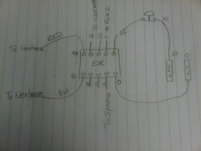

Re: MicroMill 2000 circa 1999-2004 Schematic and Photo
If the E-Stop relay is switching then the problem will have to be with either the relay itself or the wiring to the Denstep.
Attached is a sketch of the E-stop circuit.
Check the wires are connected correctly.
With the power to the machine disconnected measure on ohms across the relay contacts with the red and blue wires in. Manually press in the centre of the contactor and the two wires should now be shorted out.
ESR WIRING.jpg (31.07 KiB) Viewed 7599 times
