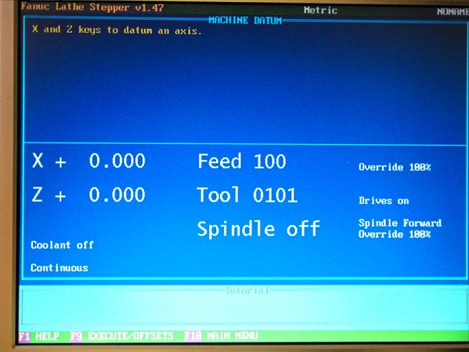

Thank you, I have read that manual and I just tried those keys again. The only keys that work on the whole keyboard is "x", "z", F9, F10, ESC, F1 when in the "machine control" section of the Flstep software. For example I can press ALT+J and the "continues" message will never change. Is there something I need to change in the .opt file to tell it to use an IBM keyboard, or in Flstep? I am still trying to use the .opt file listed above. I have included a screen shot of what I am seeing. This is what it shows after I trick the machine into homing. It seems like it still does not think its homed because it still say press "x" or "z" to datum the machine. I have read and tried everything I can find on the forum and am thinking its either the .opt or I should not be using Flstep.

Re: Microturn opt file issues
I can't see anything in the .opt that would cause it not to enter the jog mode.
In order to get it up & running you could swap over a pair of drive wires on the control card in the back. There may a another reason for it but this would revese the direction of the stepper motor. I am not sure what color wires you will have in you're machine but they be , Red,Yellow,Orange & Black. (red & yellow are 1 coil, orange & black are the second coil) if you change say red & yellow over then the direction should change. It may be later that you find the movement could be different from the display but it's worth trying first.
