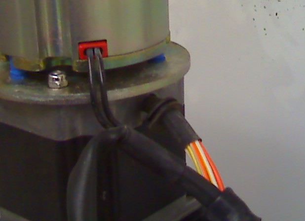

There was no resistance when we checked the orange and black wires. The orange wire goes into the motor and the black goes to the break. So I am pretty sure ithe problem is with the orange or the motor. I have attached a pic.

Re: No movement in the Z axis
The motor shown is an 8 lead version.
There will be 10 wires in all going to the motor.
2 are Black going to the Brake.
The wires going from the motor connector up to the motor are extended and will change colour.
There are 4 windings in the motor and these will be wired in series.
This means that of the 8 wires out of the motor, 4 will be extended and go back to the orange connector.
The other 4 wires are paired up and will be joined as pairs.
The colours of the motor wires shown in your photo are not the what I expected but I would suspect that the problem will be found in one of the joints where the cables are extended.
I suggest that you take the lids off the trunking inside the machine and pull out the motor wires tracing them back to the motor.
If you follow the orrange and black wires back you will find where they have been extended. If you remove the sleeving on the joints and check the connection I think you will find the problem.
If it is not on one of these two joints then I think you will have to strip out the cable back to the motor. You will then find where the other ends of the phases are linked together and have to check those joints too.

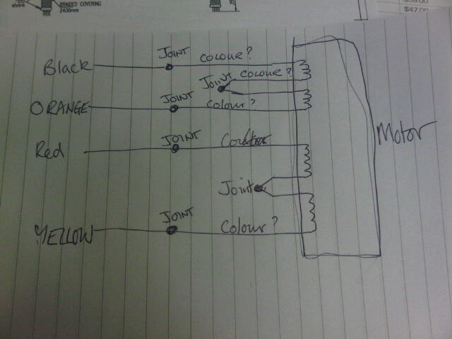

Here is a diagram showing how the motor is wired.
It does not show the brake wires.
The blobs show soldered joints

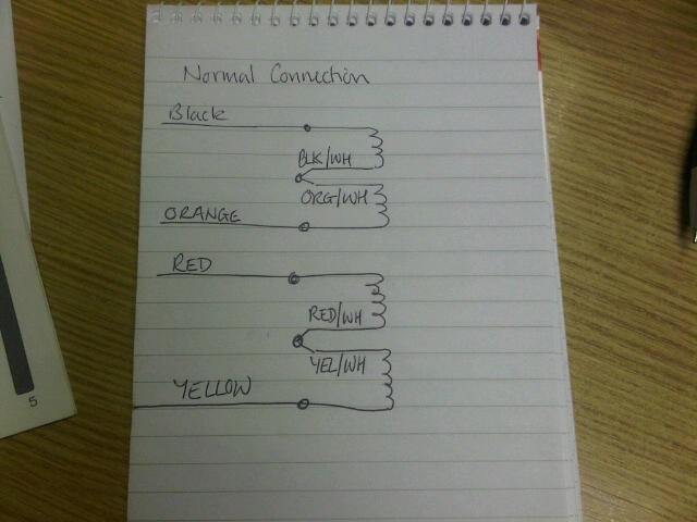

From the photo I can not see all the motor wire colours but I attach another sketch showing the wire colours I expected.
This is the wiring for a series wired motor driven by the NextMove drive. The 2A stepper drive current passes through both windings.
