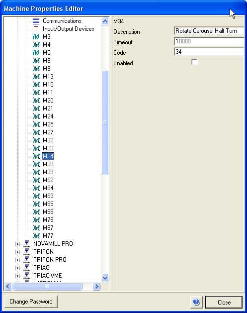

Hi everyone, I have a Novamill and the turret indexer is out of position. When I go to do a tool change the indexer is lining up half way between the tool positions. Does anyone have a solution to my problem.
I know how to reference T1, move the indexer in, out and turn it cw & ccw in MDI.
:delirious:
Re: Novamill Turret out of position
There is an M code to do all the toolchanger functions.
If you go into setup and look at the machine capability it lists them all.
M34 indexes half a pocket.
Once it is in position index to pos 1 and reteach.
Thank you Steve worked straight away :loads-a-money: :P
